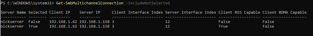

PS C:\Windows\system32> Get-SmbMultichannelConnection -IncludeNotSelected
Server Name Selected Client IP   Server IP  Client Interface Index Server Interface Index Client RSS Capable Client RDMA Capable
10.6.13.17  False    10.6.13.18  10.6.13.17 16                     7                      False              True
10.6.13.17  True     10.6.13.18  10.6.13.17 16                     7                      True               False
10.6.13.17  False    172.20.0.46 10.32.0.46 4                      10                     True               False
10.6.13.17  False    172.20.0.46 10.6.13.17 4                      7                      False              True
10.6.13.17  False    172.20.0.46 10.6.13.17 4                      7                      True               False
The connections that are probably useful here are those between 10.6.13.18 and 10.6.13.17. For some reason I have two connections where RSS is enabled while RDMA is disabled, and vise versa. I don't know if this is by design or there is some other setting that I missed to have a single connection be RSS and RDMA capable.
I don't have the time to do further testing with this for a while, but it seems like the RSS capable connection is selected most of the time, while I only saw the RDMA capable connection get selected once in a random test.

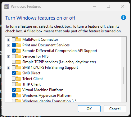

I could be wrong, but my understanding is that only Windows 11 for Workstations (and relevant server SKUs) support RDMA.
That’s a pretty hefty overhead in terms of licensing cost. They don’t even make it even remotely easy to find for purchase.
From some of the charts that I looked at, SMB Direct is available for Workstation/Enterprise/Education editions, excluding the server editions. I am using Windows 11 Education in the test but Education features have been very difficult to track over the years since when I first got Windows 10 Education, it is basically Enterprise without Cortana and a little bit extra, but Windows 11 Education has a lot more differences...
EDIT:
This is what I see in the Windows Features window so hopefully this does mean I can get RDMA working someday when I get more time again :D
Edited by Percutio

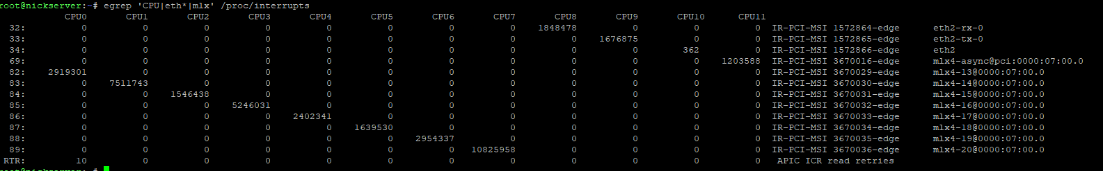

But in unraid I get zero lines with "egrep 'CPU|eth1' /proc/interrupts":
(eth0 is the non RSS capable onboard NIC)
I'm using the same card, and I'm pretty sure my configuration is working for RSS.  The "this command must show..." just doesn't account for how the mellanox driver reports its interrupts (maybe only in certain configurations of the card/driver/firmware?). Try:
# egrep 'CPU|eth*|mlx' /proc/interrupts
On the Windows side, you may also want to run something like the following, in an admin Powershell:
> Set-NetAdapterRss  -Name "Ethernet_10Gbe" -MaxProcessors 6 -NumberOfReceiveQueues 6 -BaseProcessorNumber 4 -MaxProcessorNumber 16 -Profile Closest

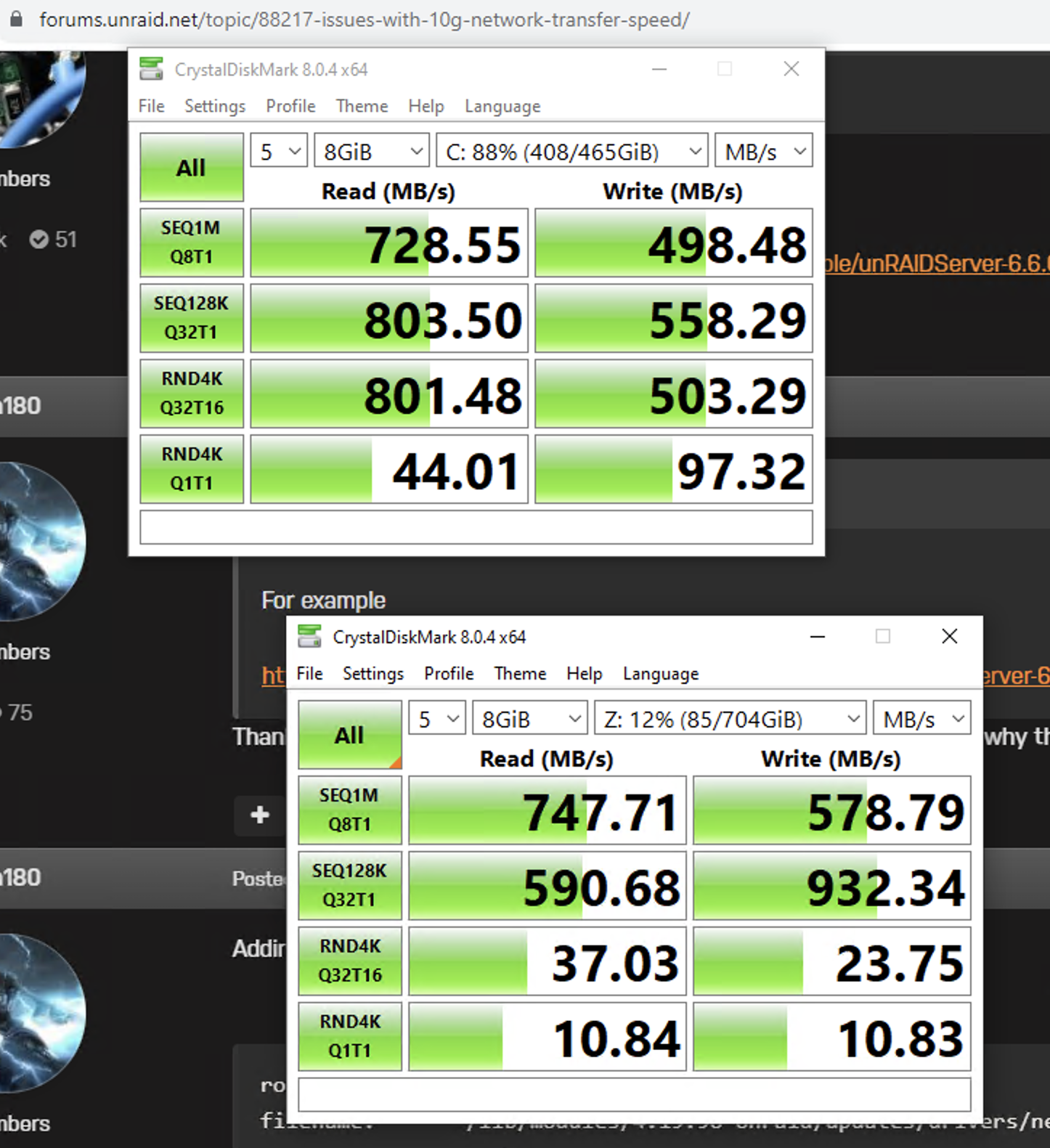

I was able to drastically improve my transfer speed from my windows machine to unraid cache drive following the RSS configuration for my intel X540-t 10gig cards, I have two 970 evo mirrored on ZFS in unraid as my cache drive. I used one of the suggested comments to access a custom "share" to bypass the overhead you can get from unraid file handling. I'm getting close to full 800MB/sec speed copying from my windows VM to unraid. Far from it the other way around. 280MB/sec max. Looks like RSS is not working the other way ? C is windows drive Z is the share on unraid.
Edited by ArthurM

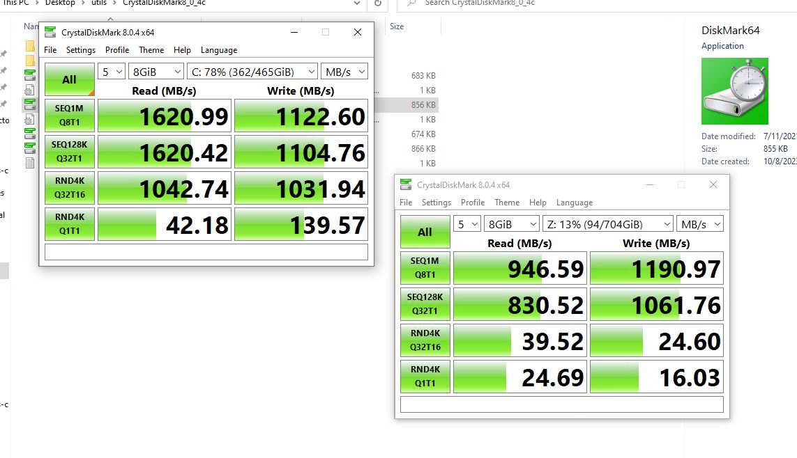

Here are my latest crystal disk benchmarks:
I had missconfigured my PCI lanes on my windows machines my nvme on my windows machine is now getting enough speed to saturate 10GIG both ways. (C is windows machine, Z is unraid) Benchmarks looks good but when copying files from Z to C only getting 300MB/sec transfer speed...

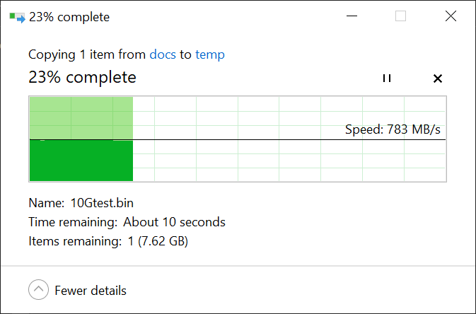

Screeshots are two large video files totalling 20GB in size.

Okay, so... my experience is I have an SMB share to my NVMe cache pool, and writing to it is literally in Kbps.
Is this a VM or bare-metal?
Bare-metal? I don't have any VMs on my server at this point and It's a true share so these are files coming from a separate computer on my network. The screenshot is from my Windows 11 PC
Run a single stream iperf test in both directions, such a low performance suggests a network problem, not an SMB issue.
I am not familiar with iperf but I could try and sort it out. But I do know I can already have multiple remux streams of different movies all running at the same time which ends up using around 600mbps of bandwidth and the downloads run at around 900mbps. Does iperf test something else?
