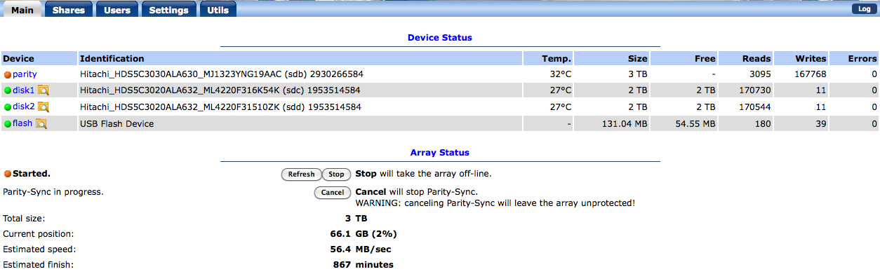

Hi
I just install a Hitachi Deskstar 5K3000 3TB and it works.
Rob
