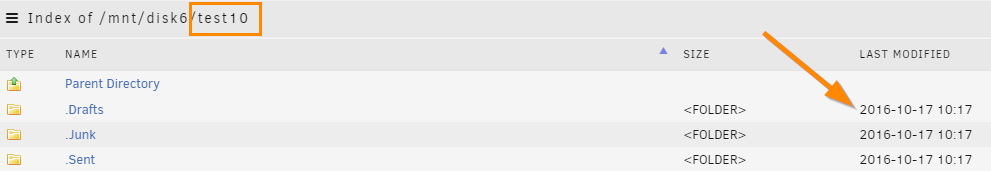

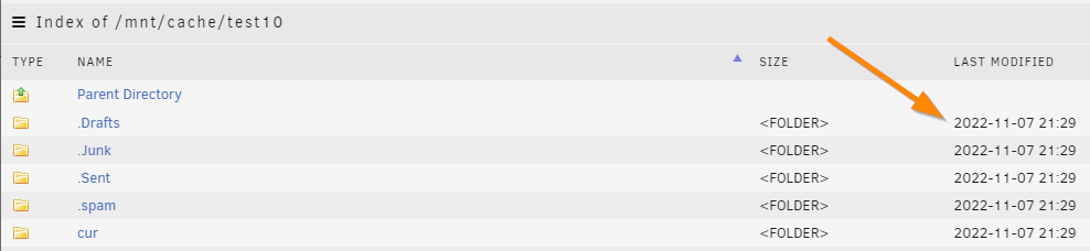

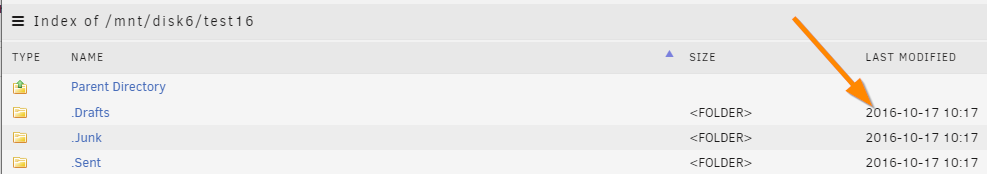

I found a strange bug, which seems to be caused of Unraid's virtual filesystem. It is noticeable if you use /mnt/user/... as destination path and as long the last backup is located on the cache. It does not happen if the last backup is fully moved to the array or if /mnt/user/... is not used as destination path.
What results through this bug:
Usually the timestamp of directories are correctly taken from the source. In this example, the directories were created in 2016:
But if the last backup is on the cache and I use it through /mnt/user as link-dest Parameter in rsync, the timestamps are overwritten by the current time:
AND: Strangely it creates all dirs on the array with the correct timestamps, too:
So they were created twice through a single rsync command?!
This is the command I used to induce the bug:
rsync --archive /mnt/remotes/MARC-PC/Users/Marc/Downloads/ /mnt/cache/test
rsync --archive --link-dest=/mnt/user/test /mnt/remotes/MARC-PC/Users/Marc/Downloads/ /mnt/user/test10
It does not happen if I use /mnt/cache as the link-dest:
rsync --archive --link-dest=/mnt/cache/test /mnt/remotes/MARC-PC/Users/Marc/Downloads/ /mnt/user/test17
Or if I use /mnt/cache as destination:
rsync --archive --link-dest=/mnt/user/test /mnt/remotes/MARC-PC/Users/Marc/Downloads/backup-2.6.2020_04-07-17_bindner/homedir/mail/iontophoresis-device.com/versand/ /mnt/cache/test19
So it happens only if both paths are set to /mnt/user/... which is the default behaviour if the destination path has been set to /mnt/user/...
At the moment I'm not sure if the script should disallow the usage of /mnt/user/... as destination path 🤔

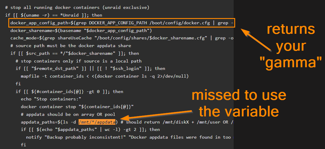

How does V1.5 behave, when the Appdata folder is not named Appdata? My Appdata path is "mnt/gamma/docker". I ran the script with this as my appdata path and i think it ran through despite giving the error that "mnt/*/appdata" could not be accessed?
From the log:
"ls: cannot access '/mnt/*/appdata': No such file or directory
Created snapshot of /mnt/gamma/docker to /mnt/gamma/.docker_snapshot
Start containers (fast method):"
I think it worked anyway, the files are there and the containers started. Is it save this way or should i edit something?
Edited by Marc Heyer
Yes, it is save. I simply forget to re-use the already obtained appdata path for an additional check:
I will fix this in the next version. Ignore it until then.
