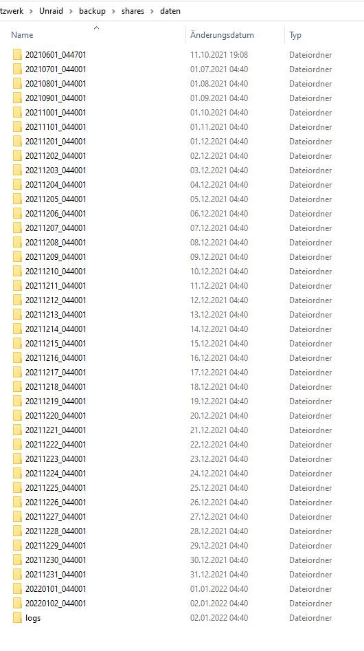

I would like to change the Skript Version from v0.6 to 1.3 and the Path.
What´s the best Way to change the Backup Paht and preserve my old Rsync Backups?
"/mnt/user/backup/shares/daten"    >>>       "/mnt/user/backup/daten"
You could move everything to a new path as follows (change diskX as needed):
mkdir /mnt/diskX/backup/daten
mv /mnt/diskX/backup/shares/daten/* /mnt/diskX/backup/daten/
The old backups will be preserved, but on the next backup hardlinking (space saving) does not work. If you even want that, you need to move the files of your most recent backup in the upper dir as follows:
mv /mnt/diskX/backup/daten/20220102_044001/daten/* /mnt/diskX/backup/daten/20220102_044001
Thank´s for your fast Reply, it works werry well!
I moved the last Backup one Level up:
mv /mnt/user/backup/daten/20220103_044001/daten/* /mnt/user/backup/daten/20220103_044001
And for the same Structure in my Monthly Backups:
mv /mnt/user/backup/daten/20210701_044001/daten/* /mnt/user/backup/daten/20210701_044001/
mv /mnt/user/backup/daten/20210801_044001/daten/* /mnt/user/backup/daten/20210801_044001/
mv /mnt/user/backup/daten/20210901_044001/daten/* /mnt/user/backup/daten/20210901_044001/
mv /mnt/user/backup/daten/20211001_044001/daten/* /mnt/user/backup/daten/20211001_044001/
mv /mnt/user/backup/daten/20211101_044001/daten/* /mnt/user/backup/daten/20211101_044001/
I hope second Step works to ;-)
Edited by schoppehermann

Greetings. I have been happily using .60 for a while now and noticed I am a few versions behind in added features. I ran the 1.3 script on a spare 8TB HD to see what changed. These are my backup paths at total about 4 TB of data. The 1.3 script takes about 2 days to run with the drive in a USB cradle. I was wondering if there was a way to have all backup paths included in one destination folder. When the script finished, I had 3 separate folders since the backup time spanned 3 days. In other words, can I change something in the script to place all 5 backup locations in one destination folder even if the backup takes multiple days? So, if I start the backup on 1-12-22 I will have one folder on the backup disk with all 5 backups in that folder (1-12-22)? (similar to the way script .6 named backup destination folders?)
backup paths
    "/mnt/user/data"        "/mnt/disks/backup3/data"
    "/mnt/disk2"        "/mnt/disks/backup3/disk2"
    "/mnt/user/backups"        "/mnt/disks/backup3/backups"
    "/mnt/user/domains"        "/mnt/disks/backup3/domains"
    "/mnt/user/isos"        "/mnt/disks/backup3/isos"
Edited by bclinton
Sorry, not possible. Even if your jobs would start at the same day: the timestamp is accurate to the second. It will be never the same.
Maybe it's possible by passing only /mnt as source and using the rsync options to include / exclude what you want in your backup. I'll test that.
PS thank you for your donation!
Ah. that didn't occur to me.....I think I got it working using the exclude option like you suggested....did a few dry runs to test and it is now backing up the data. Will take about a 30 hours so I'll know tomorrow. I'm wondering what will happen when I do another backup next week to the data. Should I see another folder with the new date along with the most recent incremental copy of the data inside that folder?
This is a screen grab of my root on the back up drive along with my change to the script. It looks like the data is being placed in the .01-12-22 folder in their correct sub folders. (I removed the H:M:S: variable so it only used the date) The folder name starts with a "." - is that normal?826022489_Screenshot2022-01-12163259.thumb.png.30f51802d1256d9400860a322e09f4fd.png
backup_jobs=(
    # source                    # destination
    "/mnt/user"        "/mnt/disks/backup3"
Excludes -
rsync_options=(
  --exclude="[Tt][Ee][Mm][Pp]/" # exclude dirs with the name "temp" or "Temp" or "TEMP"
  --exclude="[Tt][Mm][Pp]/" # exclude dirs with the name "tmp" or "Tmp" or "TMP"
  --exclude="Cache/" # exclude dirs with the name "Cache"
  --exclude="[Pp][Ll][Ee][Xx]/"
  --exclude="[Aa][Pp][Pp][Dd][Aa][Tt][Aa]/"
  --exclude="[Dd][Oo][Ww][Nn][Ll][Oo][Aa][Dd][Ss]/"
  --exclude="[Ss][Yy][Ss][Tt][Ee][Mm]/"
backup drive....
Thanks for the help!
Edited by bclinton
Yeah exclude works, but by that you need to add every new folder which is added under /mnt/user.
Instead try this if you use /mnt/user as source:
--include="data**"
--include="backups**"
--include="isos**"
--include="domains**"
--exclude="*"
By that everything is excluded except the includes
Or if you use /mnt as source:
--include="disk2**"
--include="user/"
--include="user/backups**"
--include="user/data**"
--include="user/isos**"
--include="user/domains**"
--exclude="*"
Note: Each parent dir needs a separate include as you can see for "user/".
Note: You don't need the other exclude entries for TMP etc. Those are only examples if you like to match folder names case insensitive.
Yes. This means the backup is still in creation. It will be renamed after it has been (successfully) finished.
Awesome. Thanks again!
