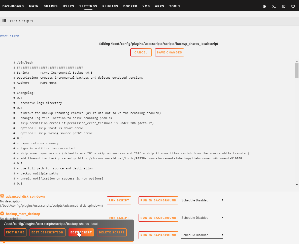

I have created the script. Do I need to make it executable? If so how? A
chmod +x
shows no effect.
I will run the script again and then post the logs here.
Don't you use the user scripts plugin?

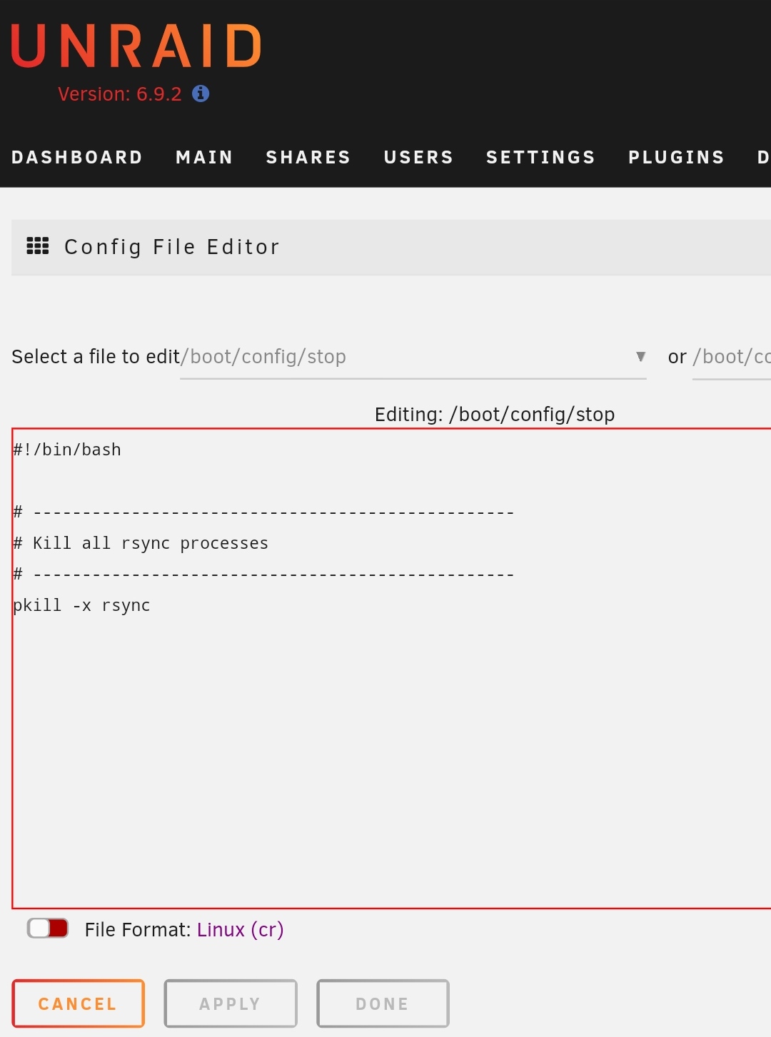

Your screenshot showed the config editor and a different path than the one for the user scripts. That's why I didn't get the idea.
Should I create the script via the UserScripts and then copy it to /boot/config?
The Plugin has its own GUI, no need to create script files:

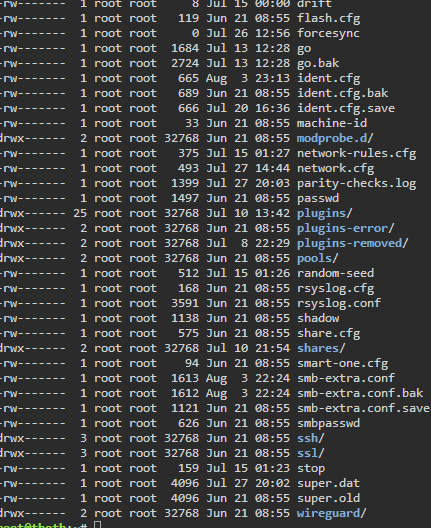

Yes, thanks, I use the user scripts. But the screenshot of your stop script pointed to /boot/config.
What do I have to do to run the user script on reboot? Just copy it to /boot/config? Or do I need to run it manually before the reboot?

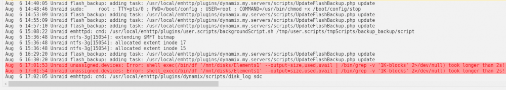

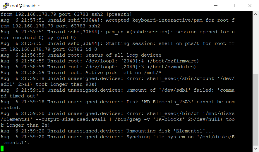

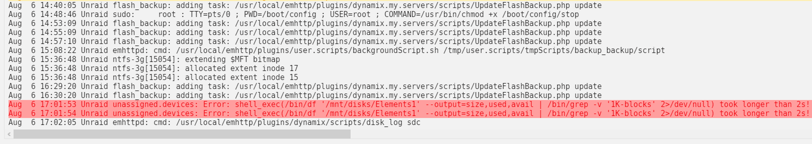

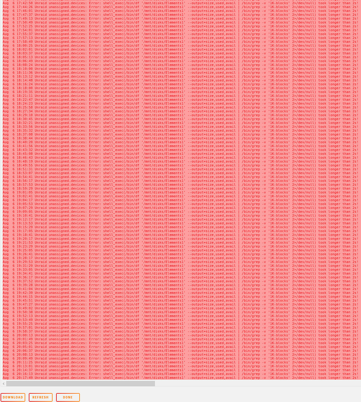

it happens again. The syslog shows:

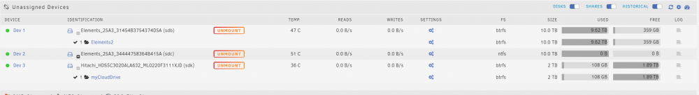

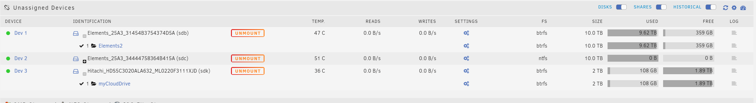

The unassigned devices - 0 free and 0 used space - no read or write speed:

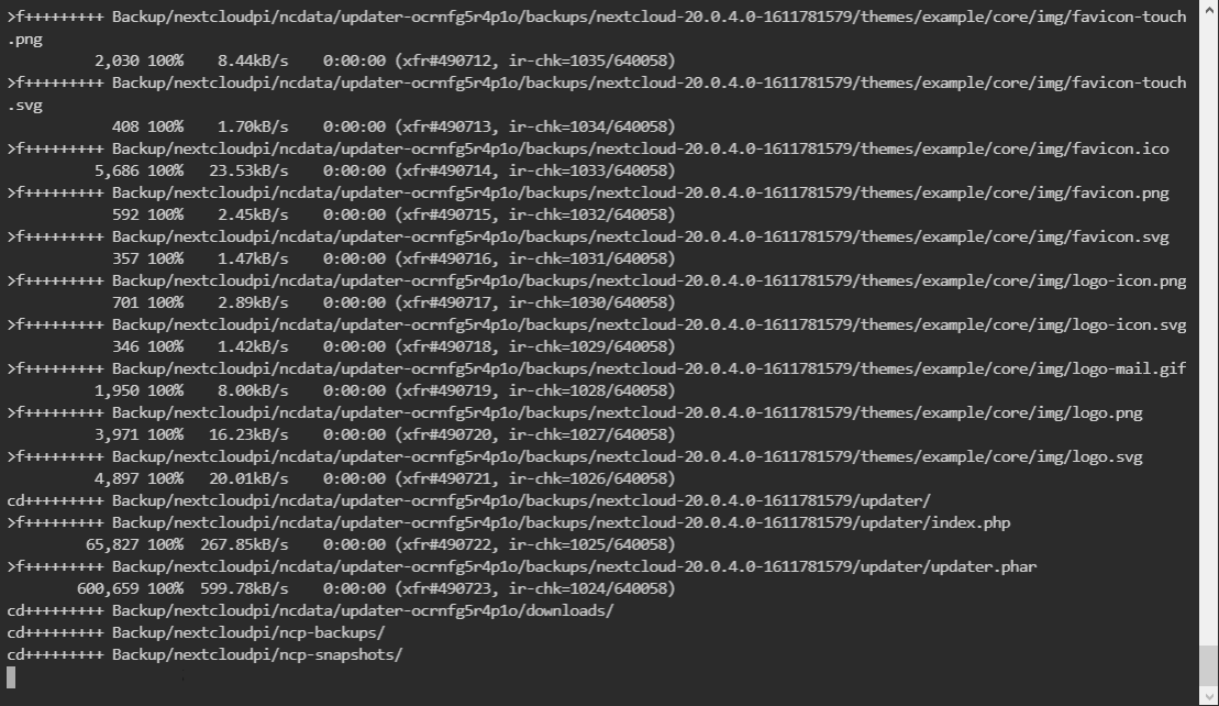

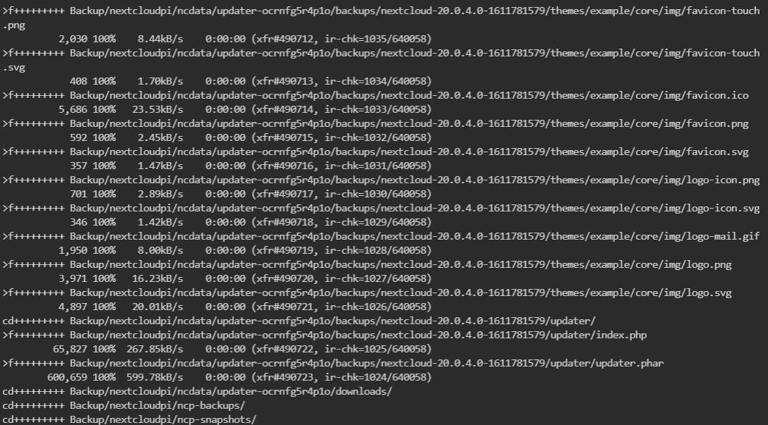

I had a window open with tail to view the output of the rsync script.
Is there anything else I can check? I would keep running this now to see if it recovers.
20 minutes ago, bonbonJaeger said:
it happens again
While the backup is running? Should be "normal". As I said. Its a timeout of the UD Plugin and not an error.
Does it still copy files or is it frozen?
Ah ok. Simply create the file:
touch /boot/config/stop
Should be sufficient. It gets the same chmod as the other files, so it should work:
For Copy & Paste:
#!/bin/bash
# Kill all rsync processes
pkill -x rsync

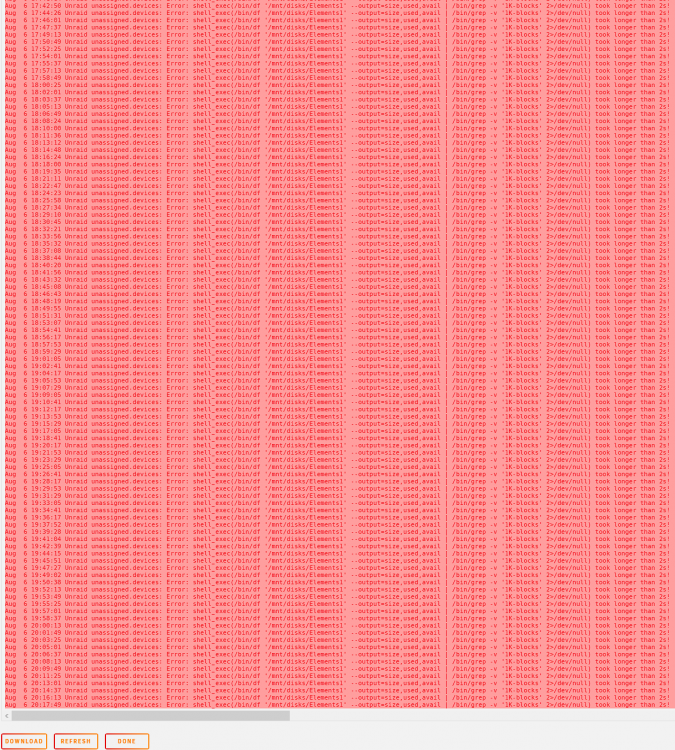

I can't tell if it's copying files. Because in the main window for the disk everything is set to 0.
The rsync-log has no new entries.
But the syslog has many error messages.
Yes, this is normal as you access the WebGUI which trys to reload the unassigned devices usage every 10 seconds or so (which fails because of the timeout).

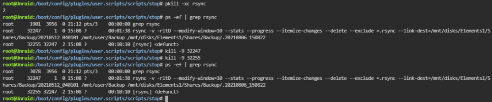

At first you should kill rsync: (x = exact match, c = count killed processes)
pkill -xc rsync
Then add "--timeout=10" to your rsync command. Rsync does never timeout without this flag.
But finally it does not solve your problem.
Maybe you should try to copy the folder manually with the "cp" command. And I would try to start a diagnosis with a vendor tool. As an example if it's an WD drive, the Data Lifeguard Diagnostic Tool.
pkill -xc rsync
that doesn't work. I will reboot. Unfortunately, the reboot does not work because the disk does not respond.

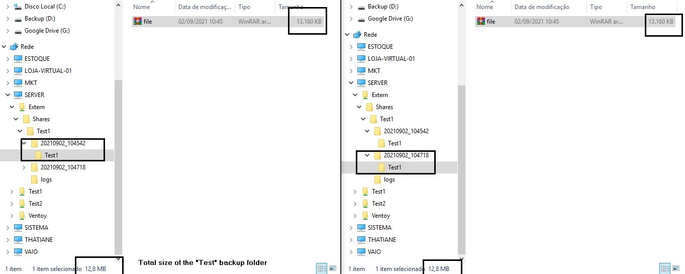

I'm using your script on Unraid 6.9.2, but it's copying all folders again. The backup size always increases.
I just modified the path:
source_paths=(
    "/mnt/user/Test1"
backup_path="/mnt/disks/Extern"
Each backup is a full backup which uses hardlinks to already existing files in previous backups. So if you create an archive from one backup, it can not take advantage of the hardlinks. Instead it copies all files.
The only solution is to create archives of multiple backups like one archive per week. But the archive type must support hardlinks preserving. Rar supports it for NTFS:
https://documentation.help/WinRAR/HELPSwOH.htm
But I do not suggest to use NTFS. NTFS has an extremely bad hardlink performance and it is not possible to backup all files that could be present on a Linux disk. For example you can't save files with a question mark in the filename and many others which are supported in Linux. Use ext4 or BTRFS. There is a free windows driver for BTRFS available.
I thought I had only one folder with all the files (incremental) and each new folder (backup) pointed to the file location.
