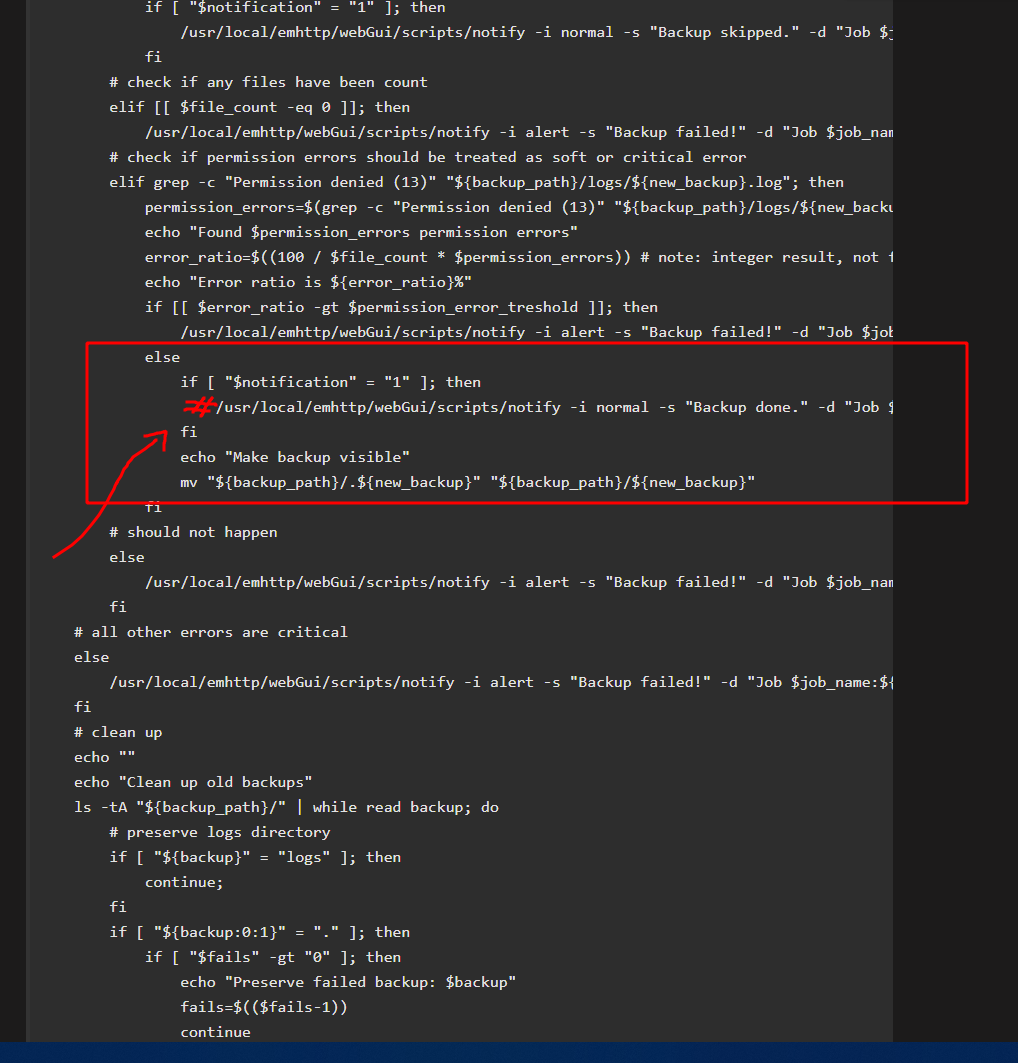

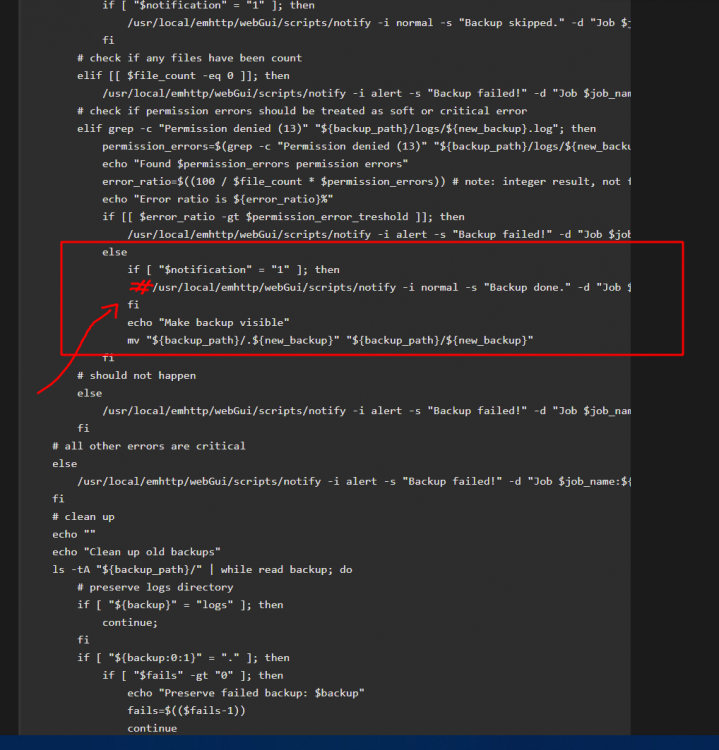

hey @mgutt, great script, thanks a lot. One question: I am using it "heavily" every 2 hours with notifications enabled. Is it possible to get only notifications when an Error occurs? I don't need the "Everything OK" notifications ;)
@mgutt or any other experienced user: any hints to my question or ist it just not possible (yet?)? :)
@nicx
may commenting out the notification will be enough?
@sonic6 wow, what a great and simple idea... I could have thought of that myself 🙄 Thanks a lot for your hint, that is really enough 👍
