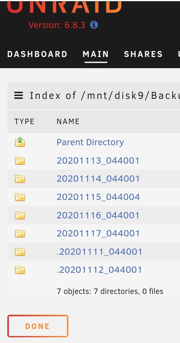

Everything fine. In the new version this text will be more clear. Explanation: A backup is created in a hidden folder like ".hidden" and is renamed only of the backup was successful. By that recent backups ignore failed backups and the user is able to directly see which backups are trustworthy and which not.
In this example the last two backup folders contain failed backups:
