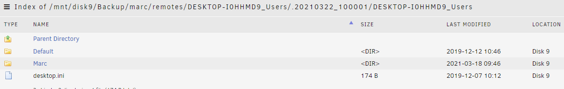

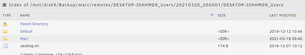

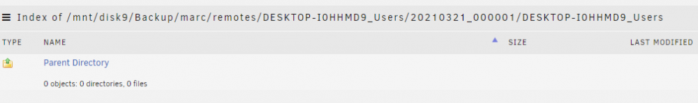

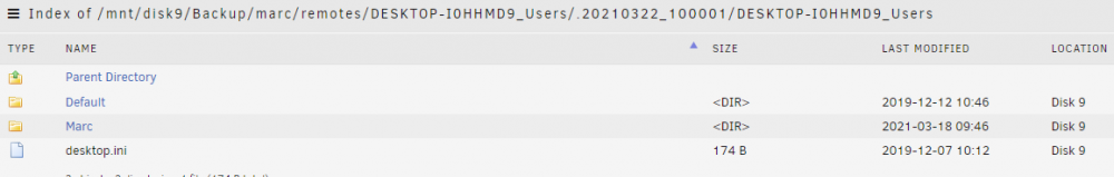

I found a bug. My PC is mounted through SMB. The backup runs every 5 hours. Now I found out that my sleeping PC returned a succesful backup, although rsync copied only the root dir of the SMB mount and returned no other errors:
Create backup of /mnt/remotes/DESKTOP-I0HHMD9_Users
Backup path has been set to /mnt/user/Backup/marc/remotes/DESKTOP-I0HHMD9_Users
Create incremental backup 20210321_000001 by using last backup 20210320_200001
sending incremental file list
DESKTOP-I0HHMD9_Users/
Number of files: 1 (dir: 1)
Number of created files: 0
Number of deleted files: 0
Number of regular files transferred: 0
Total file size: 0 bytes
Total transferred file size: 0 bytes
Literal data: 0 bytes
Matched data: 0 bytes
File list size: 0
File list generation time: 0.001 seconds
File list transfer time: 0.000 seconds
Total bytes sent: 75
Total bytes received: 27
sent 75 bytes  received 27 bytes  204.00 bytes/sec
total size is 0  speedup is 0.00
The backup dir is empty:
The last backup exists:
This bug is not dangerous, because after powering on my PC, the new backup is created as usual:
But its not incremental anymore as it was compared with the last empty backup.
I don't know why the SMB mount returns an empty result. Shouldn't it return "host is offline"?! I need to check that further while my PC is sleeping.
Maybe its the best to mark backups as failed if they contain only one empty dir.

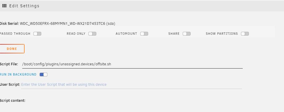

Hi all.....I have noticed that I am unable to unmount the USB disk even after the backup script finishes. I run it in background mode and it apparently affects the unmounting of the drive. I click unmount on the UD entry and it pauses a split second and stays mounted. Looking at the drive settings below it shows the backup script. Is there a command I can run to stop the script manually?
