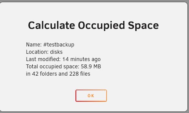

Hi!
Great script, I am planning on using this for main daily filebackup.
If I check the filesizes via the console like
du -d1 -h /mnt/disks/backup | sort -k2
13M     /mnt/disks/backup_hdd/#testbackup
11M     /mnt/disks/backup_hdd/#testbackup/20240228_171307
4.0K    /mnt/disks/backup_hdd/#testbackup/20240228_171556
4.0K    /mnt/disks/backup_hdd/#testbackup/20240228_171932
4.0K    /mnt/disks/backup_hdd/#testbackup/20240228_175035
1.8M    /mnt/disks/backup_hdd/#testbackup/20240228_175310
I can see looking at the foldersizes, that only changes/new files are copied, so hardlinks seem to work.
But when calculating the foldersize with the unraid file manager it adds all folders up (as if the backups are all full backups).
Same behaviour within the webui of my Synology NAS.
How can I prevent Unraid to show wrong values of used disk space? Or is it only shown wrong within Unraid's file manager?
Thanks for your help!
edit:
Since I'm quite new to the behaviour of hardlinks I was a bit hesitant and wanted to make sure, my backup storage won't be eaten up because of a wrong config on my side.
But I tested it and the used disc space on the Unraid 'Main' page doen't change, when doing an incremental backup without any new data. But the backupfolder size gets bigger, which is irritating at first :)
Thanks again for sharing this script :)
Edited by Jaytie

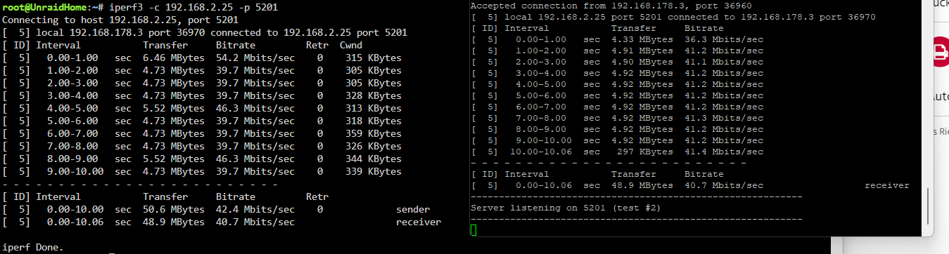

Since i moved the NAS to my sisters House i have some problems.
Our two Houses are connected with Lan to Lan Connection over Wireguard (Fritzbox). I have tested the speeds from my Unraid Server to the NAS with iperf3 as shown.
My Problem is when the script runs it drops significant in performance. Can someone explain to me where i can see the actual transferspeed of the script or some code i put into it for the log?
Grüße, Flo
A week of back an forth after the Post i finally got it to work, sort of. I start the Script now on my Remote NAS with only the read permission and the Rsync Container how suggested on the first Page.
Now i can backup my data at full speed. But one Error is left. Can someone explain to me this Error?
