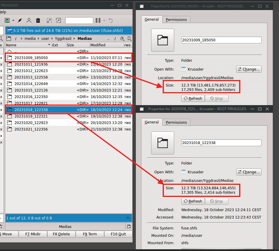

In File Explorer (Krusader here), it looks like :
180102394_Capturedecran2023-10-22a12_24_51.thumb.png.1b408796c7d28f850202b81db94ba15e.png
Every folder seems to have the same size, but the script do symlink, so if you check that, you can see it is incremental :
root@Helheim:~# du -d1 -h /mnt/user/Yggdrasil/Medias | sort -k2
13T     /mnt/user/Yggdrasil/Medias

Just delete the old folder, and if the files were only present in that one, it will be deleted.
K.

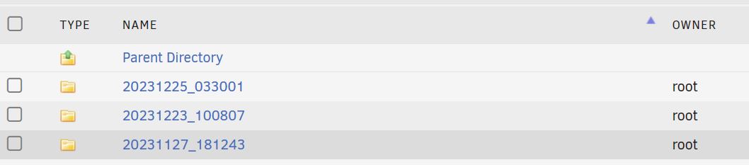

8 hours ago, Stupot said:
Is there a way to make it so I can open the log files from my computer?
You could run the New Permissions tool against that file ('newperms' from the command line).  The permissions shown will not let it be visible across the network.
16 hours ago, mgutt said:
I tend to say no. I mean why should anyone provide access to backups through a network share. This sounds like a very bad idea.
Ok that would make sense, only the log file is the *only* file that I cannot open in the backups.  All the files it backs up I can open from a Windows PC using SMB and my normal login credentials.
I also have remote access to my backups (read only) from my home lan. I saw the same problem some time ago : I think it's the owner of the log file that is assigned to "root" rather than the default "nobody"!
