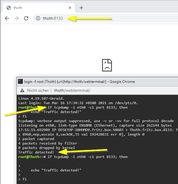

Another solution is to search for this line in my script:
if [[ -d "/tmp/${0///}" ]] || ! mkdir "/tmp/${0///}"; then exit 1; fi; trap 'rmdir "/tmp/${0///}"' EXIT;
And add this after it:
if tcpdump -i eth0 -c1 port 8133; then
    echo "Traffic detected!"
fi
Now set a custom cron to execute the script every 5 minutes:
*/5 * * * *
Now the script is executed every 5 minutes, but only one session stays open and monitors traffic on port 8133 (you can change this port of course).
Now you only need to open the link "http://tower:8133" in your browser, which returns an error, because the page does not exist, but it will execute the backup script as it detected this connection attempt:

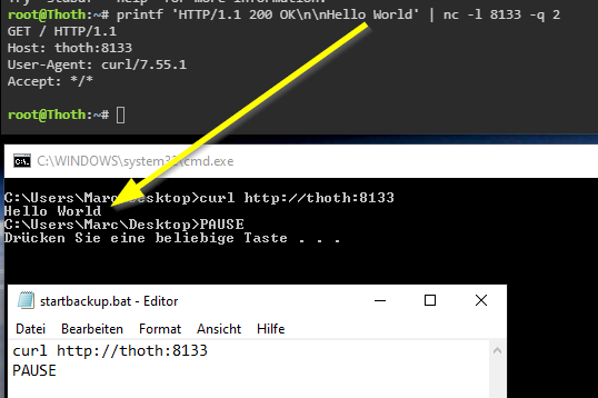

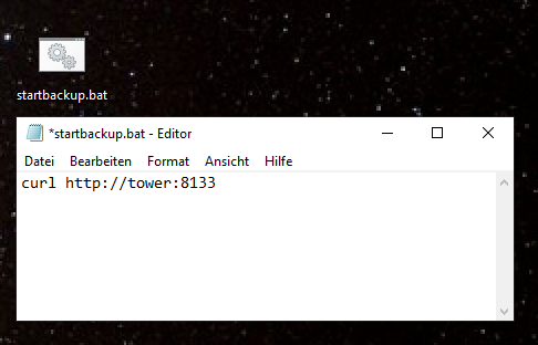

Opening a website, which does not return anything is strange? Ok, then create a startbackup.bat file on your windows desktop and use a text editor with the following content:
curl http://tower:8133
Screenshot:
Double-click the file and it tries to open this link. After some seconds the window automatically closes. The script on the server detected the traffic and starts the backup.
And there is even more crazy stuff possible, like sending an answer ^^
By that it would be even possible to output the rsync logs to the client, but this would need some extra work.
