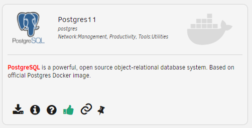

9 hours ago, itlists said:
Thanks for the reply. I'm not too handy with DB commands. Is there a particular postgresql docker and a DB management docker you recommend to setup the user and DB in postgresql?
Yep! This one here.
When you install it you can install the latest verison which is :13 instead of :11 if you want.
Or leave it at latest, but warning it will auto-update to 13.x or 14 when those are released which may include breaking changes.
Thanks for the instructions!
How do I choose :13 during the install?
Edited by itlists
In the repository field (may need to toggle advanced in top right corner) it'll say postgres:11 you can change that to postges:13 or postgres:latest

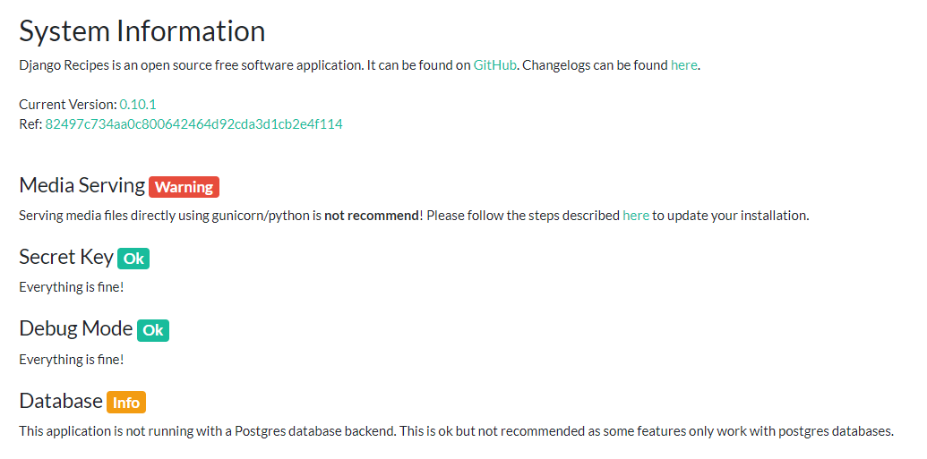

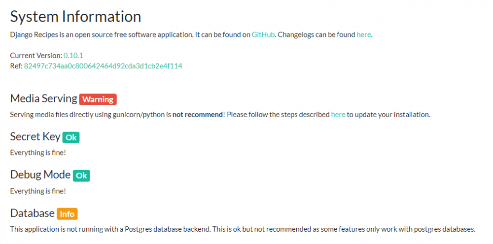

However, in System settings, the database warning still shows up:
Database Info
This application is not running with a Postgres database backend. This is ok but not recommended as some features only work with postgres databases.
This is setup to use postgres, so why?
Edited by itlists
On 10/28/2020 at 4:42 PM, itlists said:
Database Info
This is an issue in the app - it has to do with the developer looking for a legacy string about how it's connecting to postgres, which I left out because it's depreciated. See here: https://github.com/vabene1111/recipes/issues/204

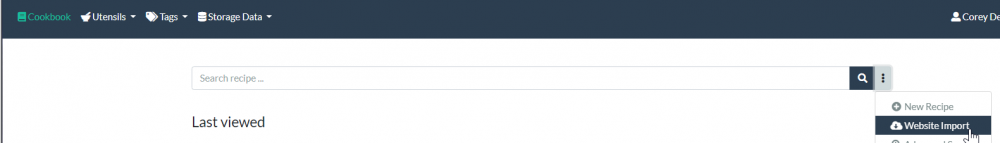

On 11/1/2020 at 10:54 PM, Blairwin said:
 I imported a recipe from URL to test it out.
This may be a silly question, but where are you finding the option to import from URL? The only option I'm seeing for importing recipes is via JSON, and I've been having trouble finding an easy way to format recipes from common websites (e.g. Allrecipes, Serious Eats, etc.) into JSON format without configuring some sort of scraper. I'm happy to do that if necessary, but wanted to check whether I was missing something first.
So from the main Cookbook page, click the three "..." icons next to search page and you can import from webiste there.
