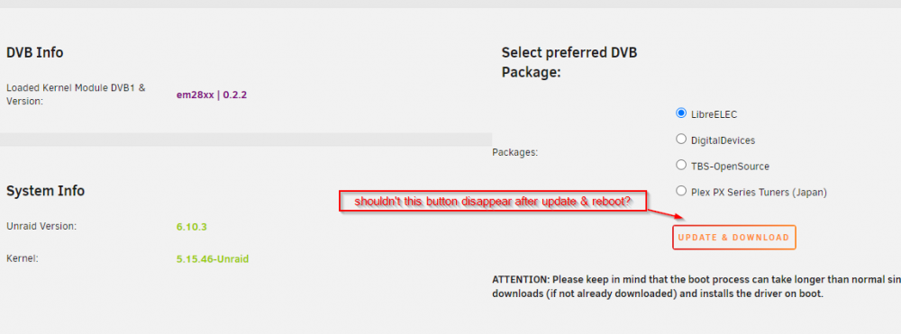

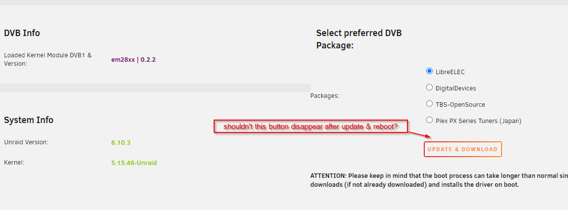

> "DOWNLOAD & UPDATE" on plugin page (libreelec package)
> reboot > still the same... and the "DOWNLOAD & UPDATE" button is there again:
new diagnostics attached!
datatower-diagnostics-20220903-1426.zip
Why should it disappear? What if you want to change the package that you've downloaded how would you do that if it disappeared?
