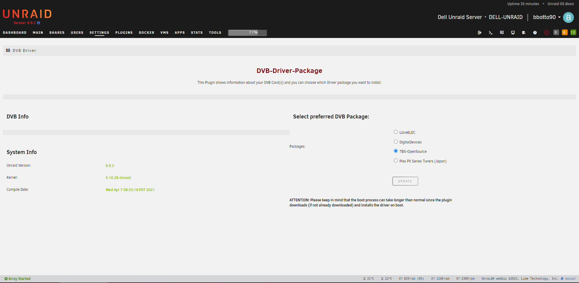

Hey All,
Im having trouble getting the DVB Plugin to recognise my USB DVB device, tuner works thru a windows setup, verified on my laptop,
Devuce is a Hauppauge WinTV-HVR-1975;
PasteBin of the lsusb -v is https://pastebin.com/WFedmxPt
I have tried all four Package Selections with no change,
Screenshot attached,
If i can get some help that would be great, looking forward to plex pvr....
