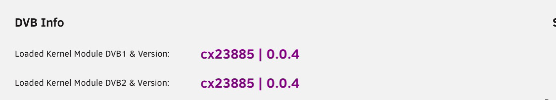

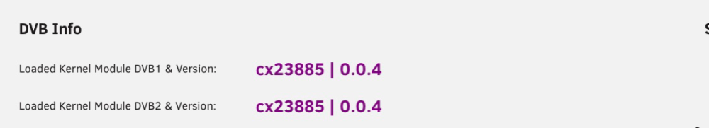

Backing it down to 6.10.3 did the trick- it is now showing up again. I included another diagnostics in case that helps at all.

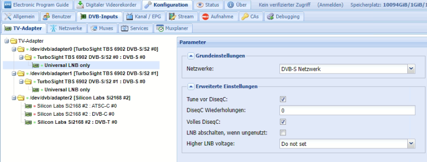

i was watching livetv yesterday and noticed that channel starting/switching takes way too long (~10secs) since i have my new TBS-6902 card and TBS-OS Driver package.
do i need to configure something more on tvheadend or is this a driver problem?

are these settings (tvheadend) correct?
never made any adjustments on previous card.
Looking correct to me.

shame on me :-\
apparently one should not activate both adapter when only one is really connected :o
switching is really fast now. sorry for your troubles!
