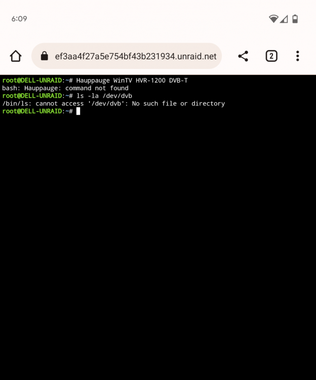

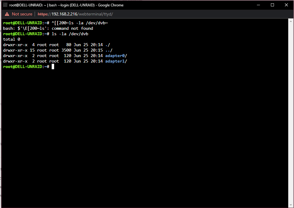

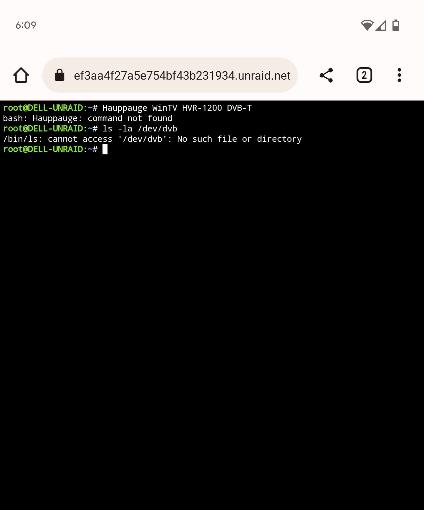

Please open up a Terminal from Unraid and post the output from:
ls -la /dev/dvb
Output attached, dvb doesnt exist, it is seen in system devices which is a start.

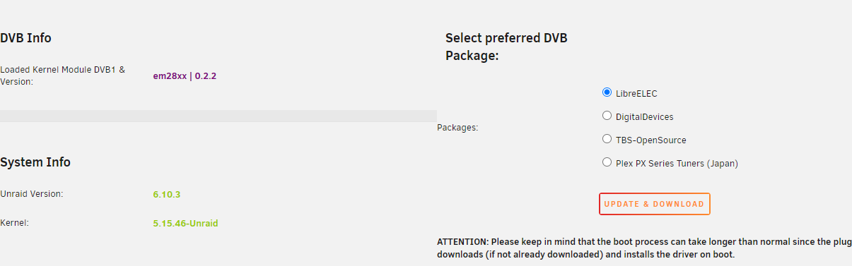

i couldn't watch any dvb-s channels anymore so i decided to update the plugin...
after that my 2 cards (dvb-t2 usb + TeVii S471 DVB-S2 PCIe) won't show up anymore.
after some investigations i found out that there's an unraid 6.10 already (was on 6.9.2) and also updated unraidOS but still no cards...
you might say i should "update & download" but i have tried this (with a reboot afterwards) and the "update & download" button just reappears...
root@DataTower:~# ls -la /dev/dvb
total 0
drwxr-xr-x  3 root root   60 Sep  2 21:52 ./
drwxr-xr-x 17 root root 3440 Sep  2 21:52 ../
drwxr-xr-x  2 root root  120 Sep  2 21:52 adapter0/
this:
just means i should hit the "update & download" button, right?
