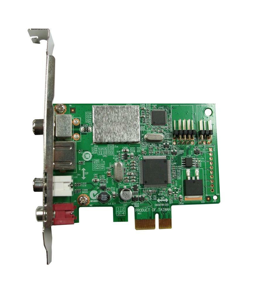

Does your card look like this: Click
On 9/11/2022 at 9:48 PM, ich777 said:
Can you install the LibreELEC drivers, reboot and then post the Diagnostics here again?
I think you have not installed the LibreELEC drivers with this Diagnostics or am I wrong?
My card looks like this:
I will try once again with LibreELEC drivers and post the diagnostics here.
