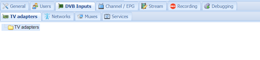

2 hours ago, wdnaser said:
may rather open a seperate topic as its not dvb driver related, you are missunderstanding the function of your card, its not a tv adapter card ... and it doesnt need any dvb drivers.
5 hours ago, wdnaser said:
But that isn't a TV adapter, is this USB HDMI Capture card supposed to work in TV Headend?
Anyways, you haven't answered a single question that I've asked above so I really can't help with this.
From my perspective this is the wrong thread for this.

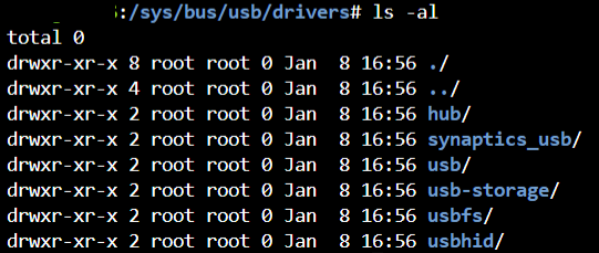

On 1/6/2023 at 3:11 AM, ich777 said:
Do you have a device called /dev/video0 in your system?
Can't find any /dev/video*
but find the undriven Capture card in /dev/bus/usb/003/003.
What is the output from:
ls -l /sys/bus/usb/drivers/snd-usb-audio/
/bin/ls: cannot access '/sys/bus/usb/drivers/snd-usb-audio/': No such file or directory
But  /sys/bus/usb/drivers has something
Edited by wdnaser
add jpg
Again, this is the wrong thread for that as explained above, this package only includes the DVB drivers from LibreELEC and not capture card drivers.
