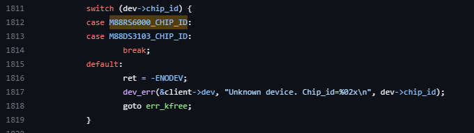

10 minutes ago, ich777 said:
Have you yet tried card=59?
I know it's a different card but it has the exact same chip as your combo card for DVB-S
TBH I really don't like these Hauppauge cards... :D
They can get pretty complicated fast... :P
Is there maybe a firmware update for the card available? I can't imagine that this is how it should work.
I get you about the Hauppauge cards, and their site is ... unhelpful.  Unfortunately it was the only accessible combo DVB-T and DVB-S card I could find (or indeed any good DVB-S card).
card=59 doesn't load - fails on the same error from the m88ds3103 driver (and doesn't even try to load the DVB-T adapter).  Going back into the source for that driver, I found this snippet - I think this is where it dies and fails the frontend setup (this is here) as if it's not one of those two hardcoded IDs (70 or 74 from the header file) then it throws an error.
I'd try slipping 71 into there to see if it passes (maybe try to load it as the RT6000 as that's what the 5525 allegedly uses according to LinuxTV), but I have no idea how to build / deploy the driver if I did.
How do firmware updates work with Hauppauge cards?  Can't seem to find any documentation on it - do I need to pop it into a Windows box and do it via their software?
I don't think this is going to work.
However I could compile the drivers but I think that needs to be fixed by Hauppauge. I would ask Hauppauge if it is even supported on Linux and why that it doesn't load properly.
I really don't know how to do that, maybe try to ask the support.
My recommendation is always to use Digital Devices or Sundtek Tuners.
Looks like this has been an issue for newer versions of these cards for a couple of years - found this git issue on Hauppauge's repo.  As far as their other documentation is concerned, the card should be supported but it feels like they haven't kept up with hardware revisions and slightly shoddy code paths.
Noted on future hardware choices!

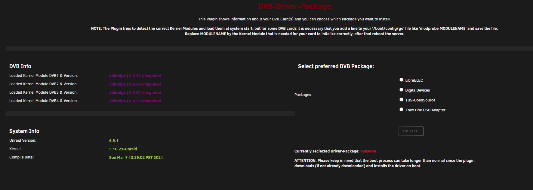

@ich777 @suyac

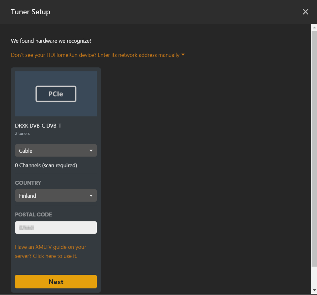

Did you guys solve this, I have pretty much the same setup, The Octopus Bridge, but with only one DuoFlex twin tuner.
Have you yet tried the DigitalDevices driver package? I see that you are using the LibreELEC package.
Which version is your DuoFlex tuner? The user from the post that you've linked has had a really old version from the card IIRC.
What is your exact issue?

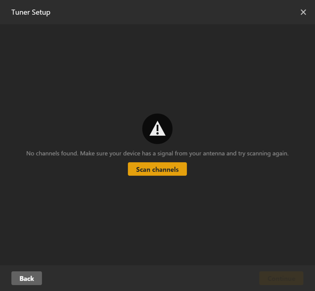

Using the Digital Devices driver package, nothing shows up, in the DVB info. And yes these are also old versions (https://www.digital-devices.eu/shop/en/tv-cards/) The Octopus Bridge, but with only one DuoFlex twin tuner, just don't remeber anymore which version, as I haven't used them for few years.
I was trying to set these up with Plex DVR, but no channels are found. Signal should be fine, I have internet coming through the same cable and using a DATA/TV splitter to split the cables.
image.thumb.png.09ccb9d2a3420fd8b6c933025e159a95.pngimage.thumb.png.0d0dfb82c0696fef2b8d254bd784980d.pngimage.thumb.png.6bea6f8f9357719ce7e2a56ecdf67278.png
If you are using Plex, you have to use a "bridge" since DigitalDevices are not supported, please look at the recommended post on top.
Ahaa, ok thank you ... I'll check.
@ich777
I think it could be a driver issue, or something else. I tested with the Digital Devices, and I don't get the /dev/dvb/ directory at all, and also the plugin DVB info is empty.
Also tried with TVheadend, and it can't find any channels, with any of the options.
Was also testing on a Windows virtual machine and found that the newest windows drivers don't seem to support the Duoflex. But I got it working with older 2.6.5.142 windows drivers., still I'd rather not run these in a VM just for this :) .. Any ideas how to run this with the plugin drivers?
Do you get /dev/dvb with the LibreELEC package? I don't think that's a driver issue because the plugin page actually lists your tunes (this is pulled from the /dev/dvb directory itself. Did you check the directory on the host or in the container?
Any logs you can provide?
Please install the LibreELEC drivers, reboot and post your Diagnostics.
@ich777
Thanks and I actually got it working, sorry for the fuzz .. I tried using the TVheadend preset muxes, and didn't realize those were really old ones. Updated them and now I got some channels visible, but some otherwise free HD channels (free on our cable providers android TV box), still seem to need a card here, and either a cable ready or a CI+ card reader .. looks like this ain't gonna work too well for me :/
I do have an old CI module and a CI reader, but apparently this needs CI+ and pairing.

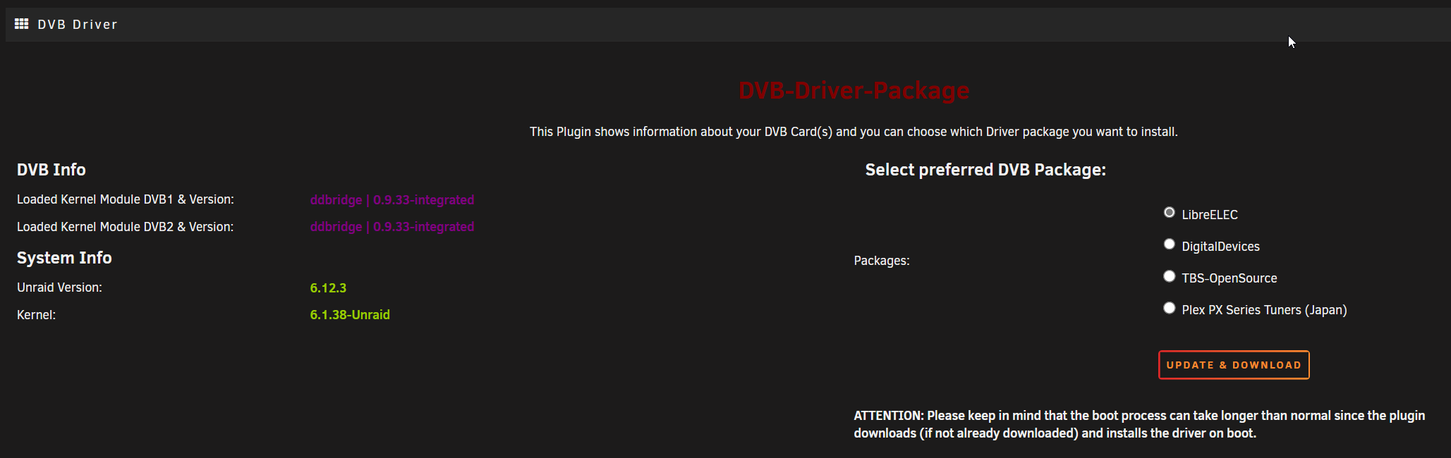

I am currently using this plugin and am on unRAID 6.11.5.  I am going to upgrade to the latest unRAID version - 6.12.4.  What is the recommended process for the sequence of upgrading the OS and the DVB-Driver plugin.  Should I upgrade unRAID first and then upgrade the plugin, or the other way around?  I am on the 2022-07-20 version of DVB-Driver.
Just use the built in upgrade assistant from Unraid itself and watch the Unraid notifications after the upgrade assistant finished, the plugin_update_helper should kick in and update the plugin ahead of time and it will tell you when it is safe to reboot or a error happened.

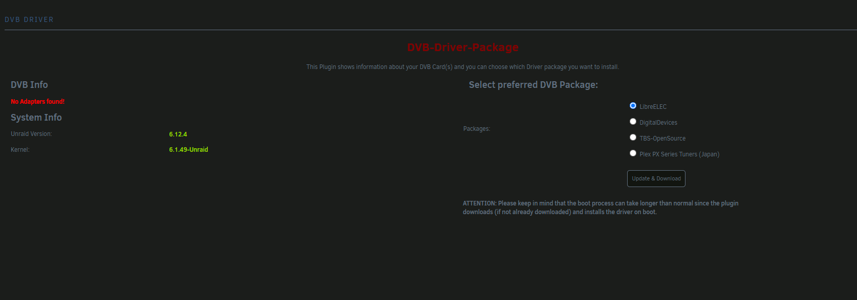

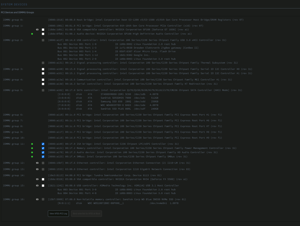

I can't get the DVB TBS 6984 Quadro card to work, it is not detected by the plug-in.
Sorry but I even don't see the device in your lspci
It seems like the device is not (properly) connected to your system.
