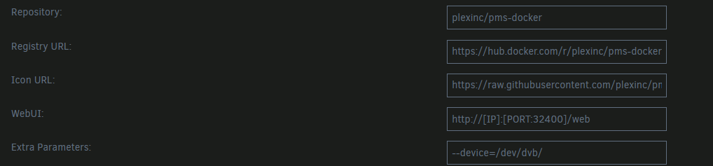

the card seems supported in plex, and you also added the device /dev/dvb in the plex docker setup ?

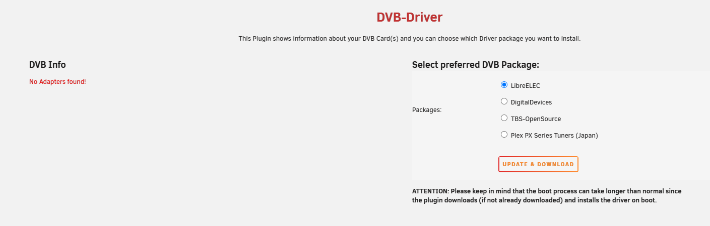

Where is the card visible on the plugin page? Do you use Plex or TVheadend?
I see 4 tuners in your recognized in your Diagnostics.
What is the output from:
ls -la /dev/dvb
Can you post a screenshot from the plugin page with the TBS driver package installed please?
Please upgrade to Unraid 6.12.8 before we continuing further troubleshooting and include new Diagnostics in the post after the upgrade.

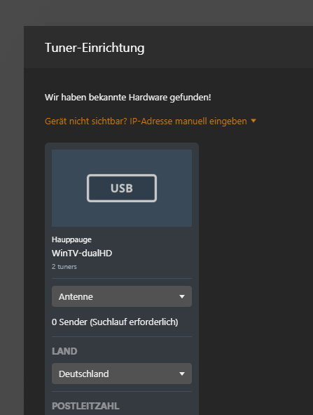

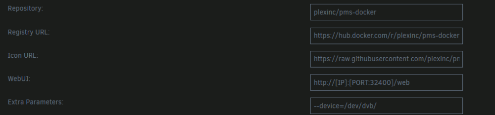

today i bought a Hauppauge WinTV dual HD USB-Stick (officially supported by plex) and i thought it would be easy to use it with the DVB-Drivers and the plex-Docker...but everything i tried, didn't helped to get it to work.
Although ist is recognized in the plex-docker:
after several minutes the DVB-Stick cannot find any channels:
The strange thing is, that the same stick is working if the plex-server is running inside a ubuntu-vm on unraid with USB-passthrough and these drivers for european tuners (at the end of the page) installed:
https://hauppauge.com/pages/support/support_linux.html
Maybe this solutions helps the developer (i don't have enough coding knowledge to do it myself):
What else can i do to make it work in the plex-docker? Any ideas? 🙂
Edited by S.P
addition
Please look at the first recommended post on top of this thread.

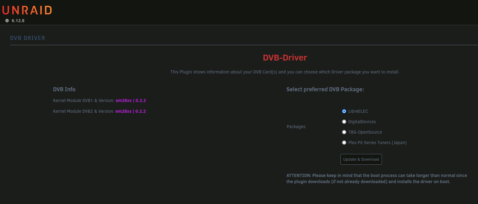

It all comes down if your camera is supported by linux and if it needs additional software to work, can you please post your Diagnostics with the driver installed?
Right so I know it works with some unix installs. I tried it on a mint vm on unraid and mint was able to run any of the cameras fine, just can't get it work with containers.... I have also tried several cameras.
Diag attached
nas-mass-diagnostics-20240507-2213.zip
Do you have the path /dev/videoX (where X stands for a number) on your system?
Your device should be covered by CONFIG_USB_VIDEO_CLASS which is included in the LibreELEC driver package.

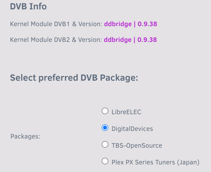

if i want to replace my tbs tv card with a dd cine 2 do i only have to select the package for DigitalDevices and reboot?
I did it that way.
Is this looking correct?

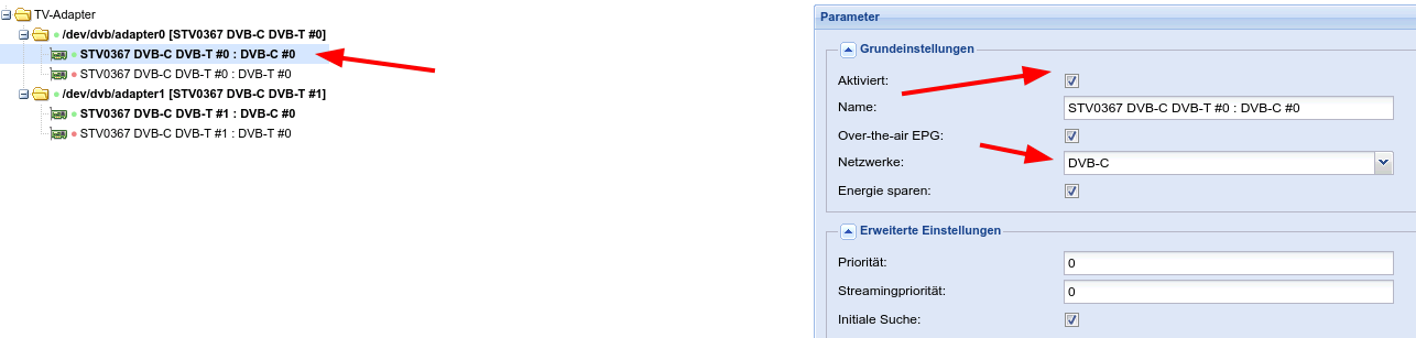

Because now I have problems with tvheadend. The tuners have a red dot and i don't know if these are the correct new one or old stuff and i need to update something.
I just want to know if i did everything correct in this plugin.
This is a thing that you have to solve in TVHeadend.
Yes.
Hint: You have to actually configure the new tuners in TVHeadend too:
