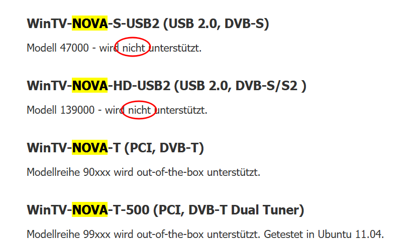

3 hours ago, alturismo said:
when i check the Hauppage support site, there is no linux support for USB S2 cards ...
https://hauppauge.de/site/support/support_linux.html#tv_tuner
from the german page
only pci devices ...
Thank you fo that.  That's very confusing/annoying, as I bought it based on the UK page saying it is supported!
Is the Ubuntu PPA mentioned some sort of workaround/add-on for Linux support? If so, could I maybe get around it by using an Ubuntu VM and passing the USB through to it?
https://www.hauppauge.co.uk/site/products/data_novas2.html

23 hours ago, Richard Harnwell said:
WinTV-NOVA-S2
This is really strange, however you can try to use the modprobe command and load the driver manually:
modprobe cx24116
However I'm not 100% sure if that will work because if they changed the chipset that obviously wont work, what you can do is issue the command from a Unraid terminal and then post new Diagnostics if it doesn't work.

5 hours ago, Richard Harnwell said:
Thanks. I tried the command. Not sure if you'd expect output from it, but there was none.
No you don't get any output.
The Hauppauge page says also that LibreELEC should work right OOB and since I compile it up to as recommended in their GitHub Repository it should in theory work.
I did a bit of research and I found multiple reports that this device is not working on Linux for multiple users.
On the LinuxTV Wiki you can see that there are two versions from this Adapter where one is working and the other one not:
There is also a HD version listed and this seems also not to be supported:
So it seems there is some misinformation on the Hauppauge page and I even can't find much information about the Vendor/Device IDs.
Anyways I am not the biggest fan from USB Tuners however if you really want to use one I would recommend one from Sundtek in combination with TVHeadend:

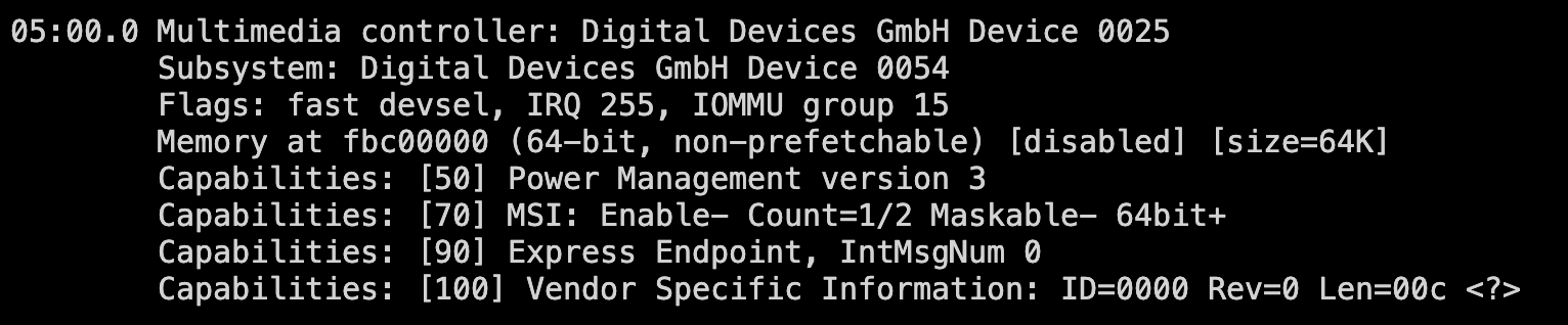

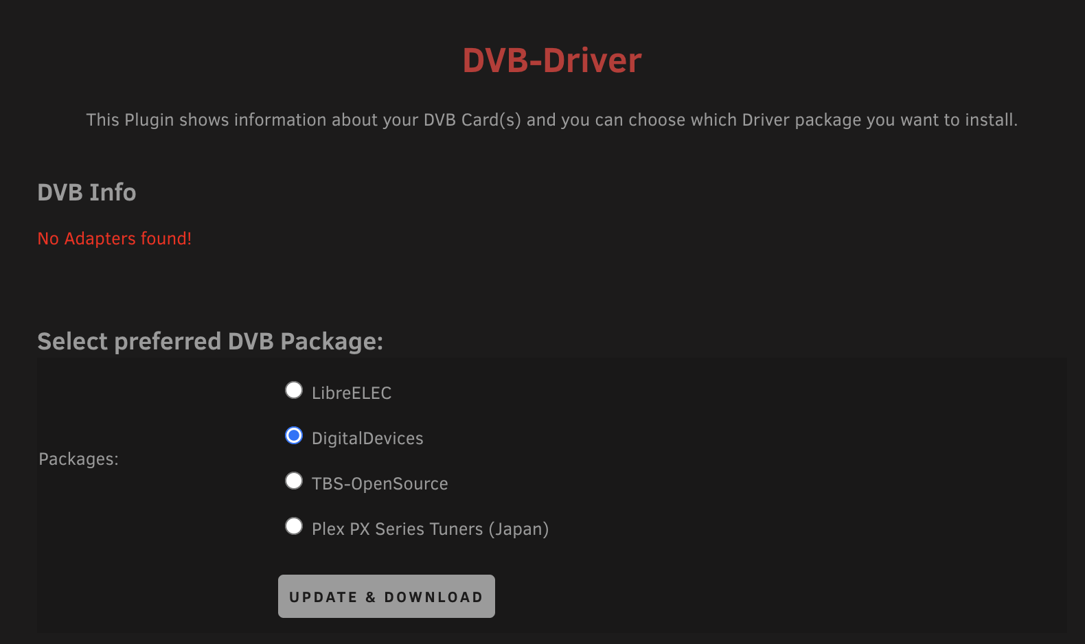

Hello,
i have a problem my DigitalDevices MAX  M2  v1 is not showing up in the Settings of the plugin. I restarted multiple times.
i have no clue where to start
Is this the first time installing the plugin or was it working before?
it was the frist time! And thanks!
Please do the following:
  1. Open up a Unraid terminal
  2. Type in: modprobe ddbridge
  3. Type in: ls -l /dev/dvb
If you get a error message about the module not being found in at step 2 thenTy:
  1. Type in: depmod -a
So now there is a solution. I update to unraid 7.1.0 Rc1 an installed the plugin new. Now its working.
Thanks
Thanks for keeping me up to date, this is really strange, however thank you for keeping me up to date.
Would you mind sharing Diagnostics from your system now?

Hey, installing the dvb drivers fresh on 7.2. I get the following error:
Package dvb-driver-2025.03.25.txz installed.
-----ERROR - ERROR - ERROR - ERROR - ERROR - ERROR - ERROR - ERROR - ERROR------
There are no GitHub API calls left for your IP.
The limit will be reset at: 2025-10-31 17:28:02
There is nothing left to say and you see the issue.
Is something eating up your GitHub API calls in your local network? To install the driver you need at least one API call.
Do you have this monitoring solution in your network is named Pi something?
