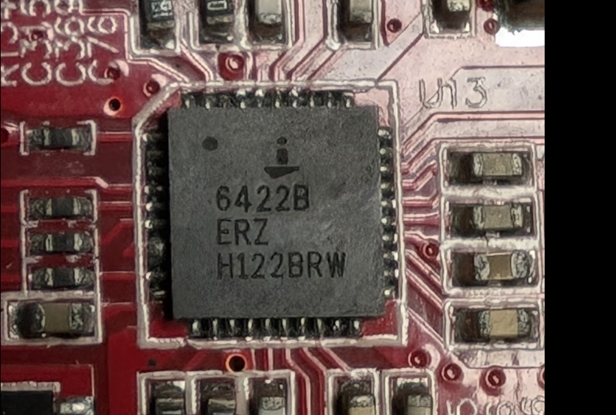

I physically checked my card and it has two ISL6422B chips onboard, I am thinking due to those kernel messages that they are not being driven correctly and producing any output to the LNBs (as per my multimeter testing):
28.494167] DVB: Unable to find symbol isl6422_attach()
I found this thread that I don't totally understand but it does seem to imply there is an issue caused by newer kernels https://github.com/ljalves/linux_media/issues/143 , it points to https://github.com/tbsdtv/linux_media/pull/361
Maybe the other users who have downloaded this plugin don't have a DVB-S card with this chip?

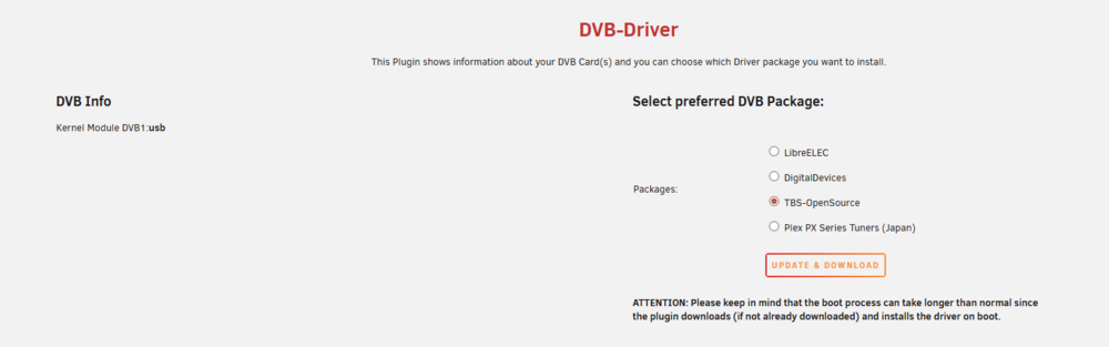

@fireplex build is now done for 6.12.13, please do the following:
  1. Remove the DVB Driver plugin
  2. Pull a fresh copy from the DVB Driver plugin from the CA App
  3. Go to the plugin page and make sure that you select/download the TBS OS driver package
  4. Reboot
The new build for 7.0.0-beta.4 will take a few additional minutes (about 10 to be precise).

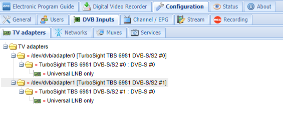

Hey! Just a quick question. I am setting up a TBS6981 DVB-S2 card, which I believe should have Unicable functionality.
I have the DVB Driver plugin installed, am using the TBS-OpenSource option, and have entered mxl58x.mode=2 in the syslinux configuration.
Is there any way I can double check/confirm that the TBS6981 card is actually in Unicable mode and working correctly? (I don't have the satellite cables run yet, so cannot check signal etc.).
This is what I see in the TVHeadend TV Adapters section.
Thanks!
Please post your Diagnostics.
Do you have issues in TVHeadend? TBH, I never configured Unicabel but a few people reported that it works as intended with DigitalDevices cards and TVHeadend.
you would have to change the setup of the tuner to unicable also in the tvh settings, currently its only regular ...
but i wonder a little, no word about unicable support atleast here
https://www.linuxtv.org/wiki/index.php/TBS6981#Overview/Features
but, without wiring you cant figure out if its working or not anyway ;)

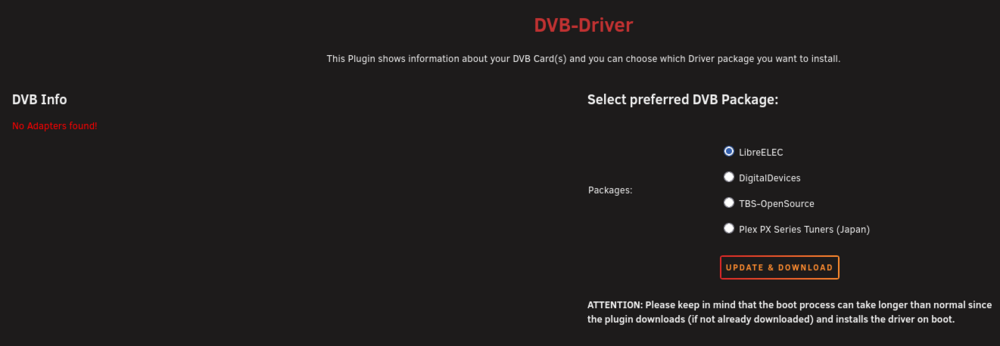

Any tips on getting this working with Hauppauge WinTV-NOVA-S2 USB dongle?
I have one plugged in, and have installed the plugin and rebooted. I see it appearing under USB devices via the System Devices plugin, but there is no /dev/dvb file/folder.
image.png.9c0d8d8836639847e4a7e06f20a2f7d3.pngimage.png.105beba93f4320d24a6200f2d551e0af.pngimage.thumb.png.13c4650924ee65cc6fa4b9d5ed7d648d.png
tower-diagnostics-20250223-2007.zip
Edited by Richard Harnwell
