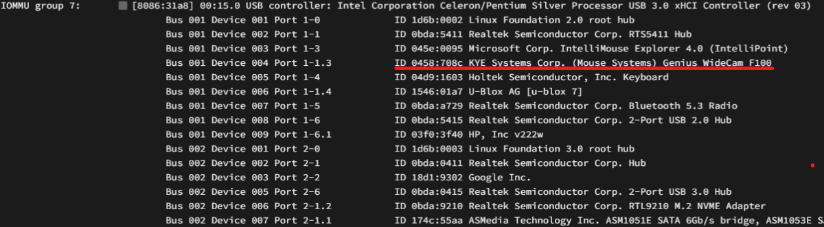

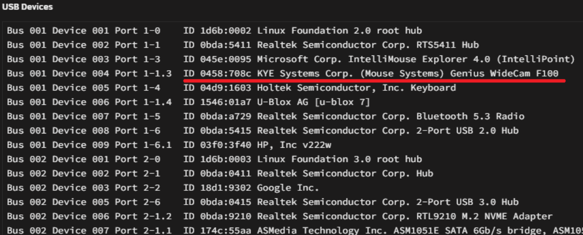

Hello,
I have a Genius WideCam F100 camera, which may not be the best quality, but it has the largest field of view I could find.
When I connected it for the first time and installed DVB Driver, it worked with mjpg-streamer. When I disconnected the camera and connected it again after some time, it no longer wanted to work.
I checked all dev/videox, tried changing packages and reinstalling drivers many times and nothing helped.
Does anyone have an idea what can be done to make this work?
smartcamp-diagnostics-20240605-1243.zip

I see that the webcam is detected just fine:
Jun  5 21:09:23 SmartCamp kernel: usb 1-1.3: Found UVC 1.00 device USB_Camera (0458:708c)
Jun  5 21:09:23 SmartCamp kernel: input: USB_Camera: USB_Camera as /devices/pci0000:00/0000:00:15.0/usb1/1-1/1-1.3/1-1.3:1.0/input/input8
Jun  5 21:09:23 SmartCamp kernel: usbcore: registered new interface driver uvcvideo

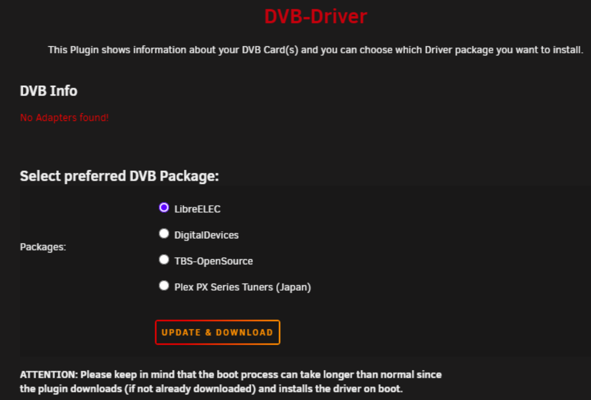

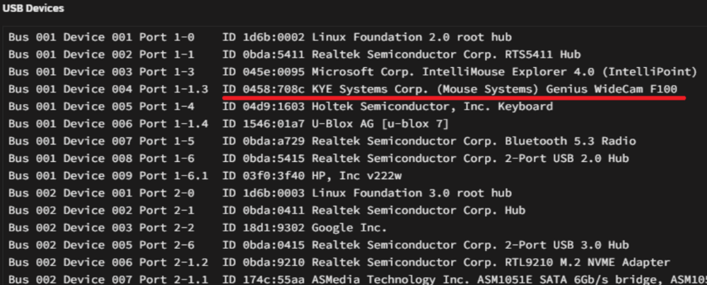

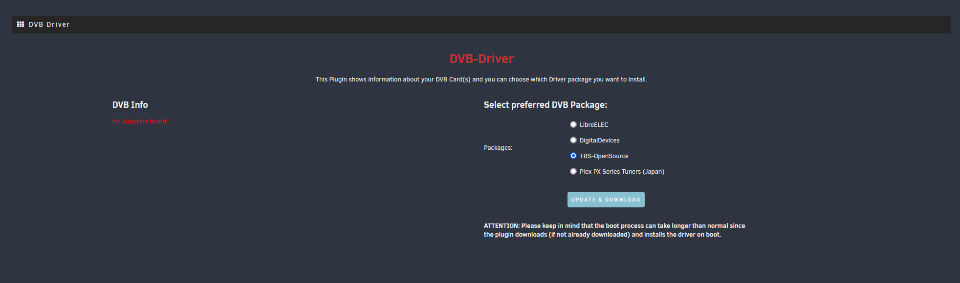

Are you also sure that Libvirt Hotplug doesn't change the device state or re-plugs it?
I removed Libvirt Hotplug and restarted the system.
Unfortunately, but still: No Adapters found!
/dev/video0 and /dev/video1 are visible in the system but the ustreamer shows < no signal > on both.
smartcamp-diagnostics-20240605-2242.zip
Sorry but this message has nothing to do with the Webcam, since the plugin is named DVB Driver it only detects DVB cards, I only include the Webcam drivers as a bonus (I might change that in the future and split it into a separate plugin.
Again, I really can't tell what changed since it registered fine:
Jun  5 22:24:01 SmartCamp kernel: usb 1-1.3: Found UVC 1.00 device USB_Camera (0458:708c)
Jun  5 22:24:01 SmartCamp kernel: input: USB_Camera: USB_Camera as /devices/pci0000:00/0000:00:15.0/usb1/1-1/1-1.3/1-1.3:1.0/input/input8
Jun  5 22:24:01 SmartCamp kernel: usbcore: registered new interface driver uvcvideo

Thanks for your reply and sorry for the confusion.
I went back to the mjpg-streamer Docker container and it turned out that the camera was working.
I don't remember at what point I changed the container from mjpg-streamer to ustreamer.
Ustreamer was supposed to be a better replacement and had everything set up the same as mjpg-streamer, but apparently something didn't work as it should and I was looking for the problem in the wrong place.
What confused me was that no device was detected in the plugin window.
