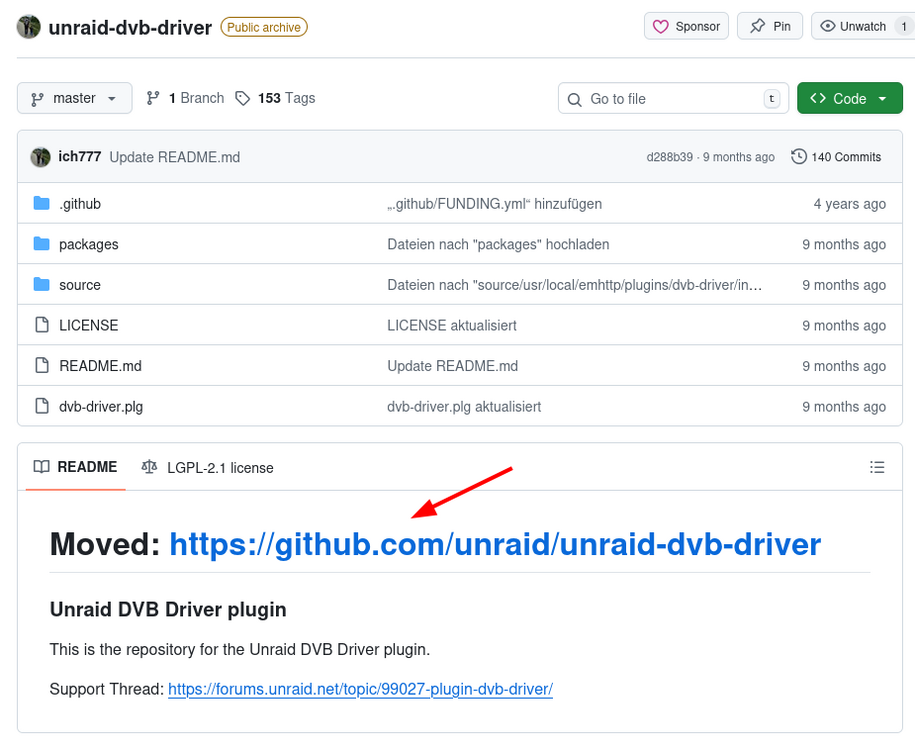

Is DVB-Driver available for Unraid version 7.2.2? Post 2 of this thread links to a Github site that shows the versions of this driver, but it seems to be deprecated as it ends at 6.8.12
I am currently running Unraid 6.12.4. I plan to upgrade soon to a more recent version, like 7.2.2. Are there any issues doing that, or do I just upgrade Unraid and then upgrade the DVB-Driver plugin?
if you check the main git site you see it moved to unraid repo, and yes, last release 2 days ago ;)

Thank you very much. When I go to that Git site it says "for Unraid Kernel v6.17.9". How do we know which Unraid Kernel matches up with Unraid version 7.2.2.
Can I suggest that someone update or delete Post #2 of this thread, or at least put warnings that it has been deprecated.
Thanks for the heads up, I've now changed the link in post two, however if you look at the repository:
The plugin was simply moved to the Unraid repository and you don't have to do anything on your side, the new repository was already pushed to the users on the last plugin update.
