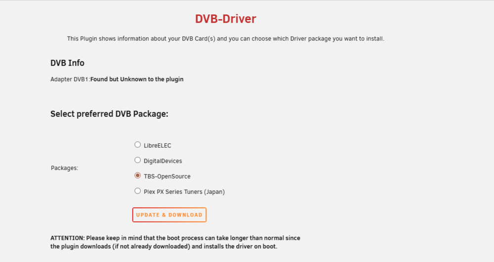

[Plugin] DVB-Driver
I discovered something new on my old server running Linux Mint, where everything works properly:
The USB sticks are detected the same way, regardless of their ID.
Bus 001 Device 005: ID 2013:0258 PCTV Systems PCTV 461
Bus 001 Device 006: ID 2013:0462 PCTV Systems PCTV 461
On the system running Unraid, however, the two sticks are detected differently.
Bus 001 Device 003 Port 1-6 ID 2013:0258 PCTV Systems DVB-S2 Stick 461e
Bus 001 Device 006 Port 1-1 ID 2013:0462 PCTV Systems PCTV 461
They are probably different hardware revisions.
On the Linux Mint system, all sticks work regardless of the revision.
Under Unraid, only the 461e works, but I have no idea why.
So now to clarify. Stick 461e works with unraid but Stick 461 not.
No Idea why and where are the different.
But maybe we can't find together I way to figure out the reason for this.
I run now Unraid 7.2.3

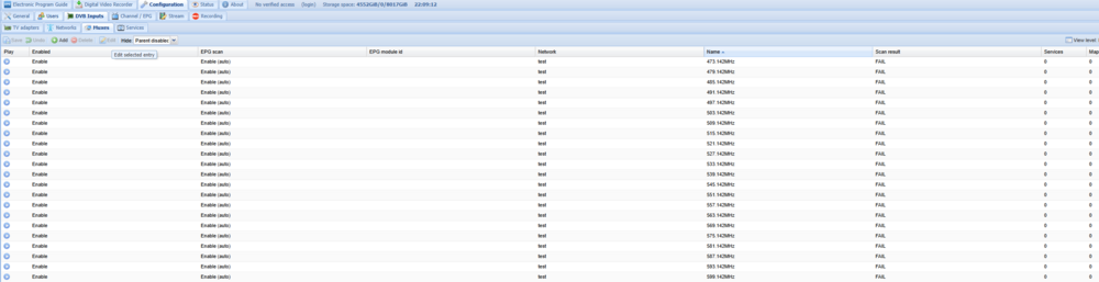

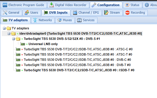

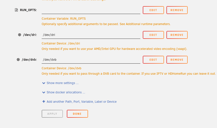

I'm trying to add TBS5530 to TVheadend in unraid, passthrough USB device as instructed, i can see the device, but no results when scanning.
I then installed DVB viewer to another PC under windows and connected TBS device and it picks up channels fine. So something is wrong in Unraid, I also noticed green light in TBS device for "Locked" doesnot power on when scanning under UNRAID but does every time when scanning frequencies in windows.
can someone help me please?
I think this is more of an issue with TVHeadend or the configuration since the card is detected and in a working state, otherwise it wouldn't be detected at all, however you can post your Diagnostics and I look through the files if there is something missing but even if there would be something missing the card wouldn't be detected usually.
I also can't help with ISDB-T since we don't have that standard over here, however as said, it seems like some other configuration issue or an issue with TVHeadend.

Thanks, so Card is properly installed. i will check with TVH forum then.

I checked with TVheadend and TBS5530 works perfectly in a separate Linux machine running TVheadend. So it must be a driver communication issue. I noticed my plugin page also shows like below.
I Have attached Diagnostic Zip file you requested too.

Apr 8 19:00:45 Unraid kernel: usb 1-2: DVB: registering adapter 0 frontend 0 (TurboSight TBS 5530 DVB-T/T2/C/C2,ISDB-T/C,ATSC,J83B)...
Apr 8 19:00:45 Unraid kernel: i2c i2c-8: found a 'Montage m88rs6060' in cold state
Apr 8 19:00:45 Unraid kernel: i2c i2c-8: downloading firmware from file 'dvb-demod-m88rs6060.fw'
Apr 8 19:00:46 Unraid kernel: e1000e 0000:01:00.0 eth1: NIC Link is Down
Apr 8 19:00:46 Unraid kernel: i2c i2c-8: found a 'Montage m88rs6060' in warm state
Apr 8 19:00:46 Unraid kernel: i2c i2c-8: firmware version:30
Apr 8 19:00:46 Unraid kernel: usb 1-2: DVB: registering adapter 0 frontend 1 (TurboSight TBS 5530 DVB-S/S2/S2X)...
Apr 8 19:00:46 Unraid kernel: dvb-usb: TurboSight TBS 5530 successfully initialized and connected.
Apr 8 22:55:27 Unraid kernel: usb 1-2: DVB: registering adapter 0 frontend 0 (TurboSight TBS 5530 DVB-T/T2/C/C2,ISDB-T/C,ATSC,J83B)...
Apr 8 22:55:28 Unraid kernel: i2c i2c-8: found a 'Montage m88rs6060' in cold state
Apr 8 22:55:28 Unraid kernel: i2c i2c-8: downloading firmware from file 'dvb-demod-m88rs6060.fw'
Apr 8 22:55:29 Unraid kernel: i2c i2c-8: found a 'Montage m88rs6060' in warm state
Apr 8 22:55:29 Unraid kernel: i2c i2c-8: firmware version:30
Apr 8 22:55:29 Unraid kernel: usb 1-2: DVB: registering adapter 0 frontend 1 (TurboSight TBS 5530 DVB-S/S2/S2X)...
Apr 8 22:55:29 Unraid kernel: dvb-usb: TurboSight TBS 5530 successfully initialized and connected.

Ok i changed, and restarted. Now USB Tuner is detected.
But still cannot search for channels, scan fails.
Sorry but this is not really helpful, no Diagnostics, no logs, nothing... Don't know what to tell you other than:
I think that might be a configuration issue in TVHeadend when the tuner is detected and scan fails (at least that's most of the times the issue).

The Plugin Update Helper said i should visit this thread to avoid plugin issues.
What to do now?
What to do now?
TBS seems to have not made their drivers compatible with the latest LTS Kernel, the are only supporting up to Kernel version 6.14.x currently.
Please try the LibreELEC drivers for now and see if they work with your Card.
I have the same problem. I switched to the LibreELEC Drivers, but that doest't seem to work.
