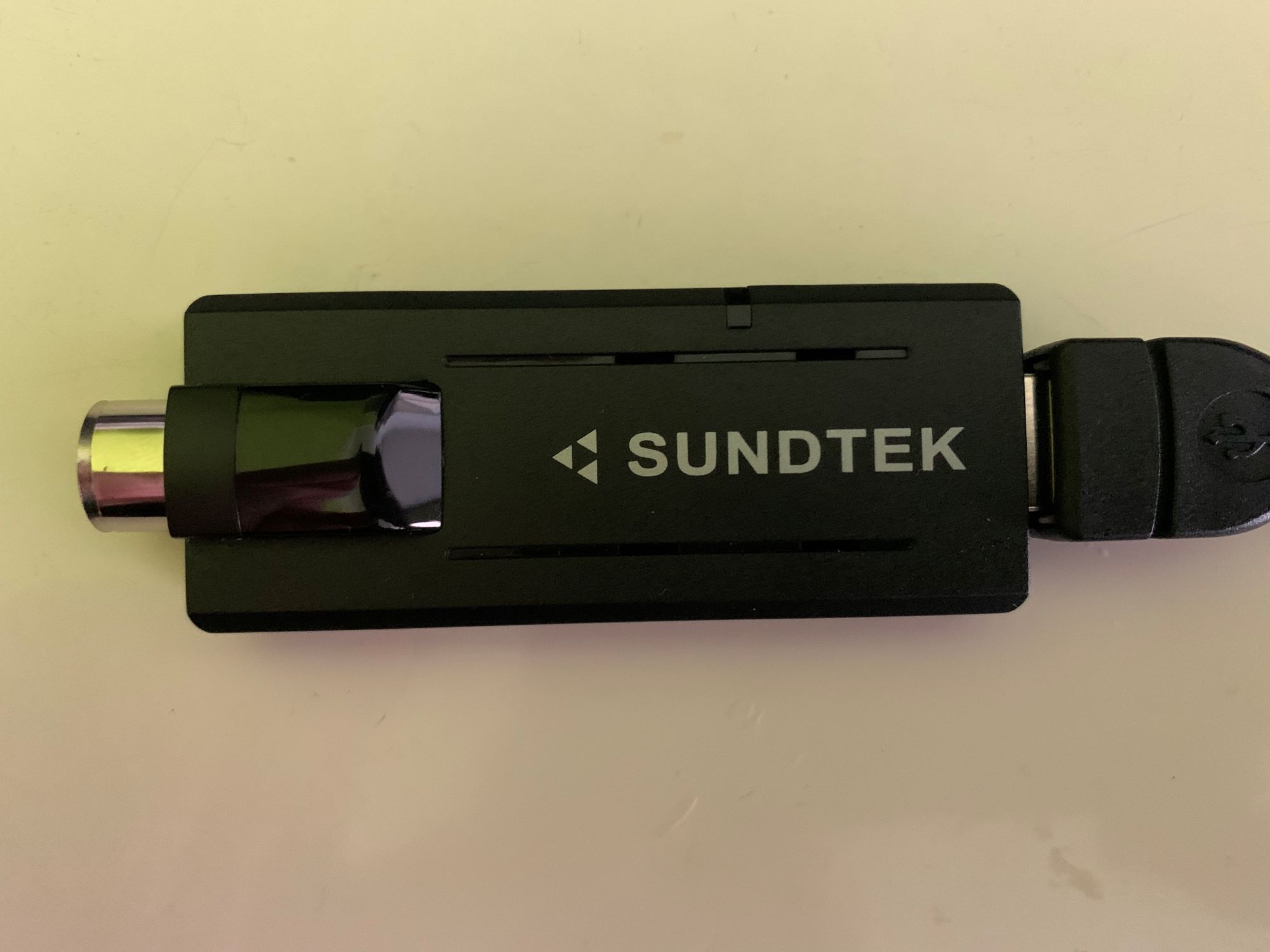

I had a little play around but for some reason the adapter is detected in unraid but the blue activity light does come on.
Over here the blue light comes on too just fine, but keep in mind only after the driver was successfully installed.
We are talking about these adapters correct:
I have no issue on my server over here:

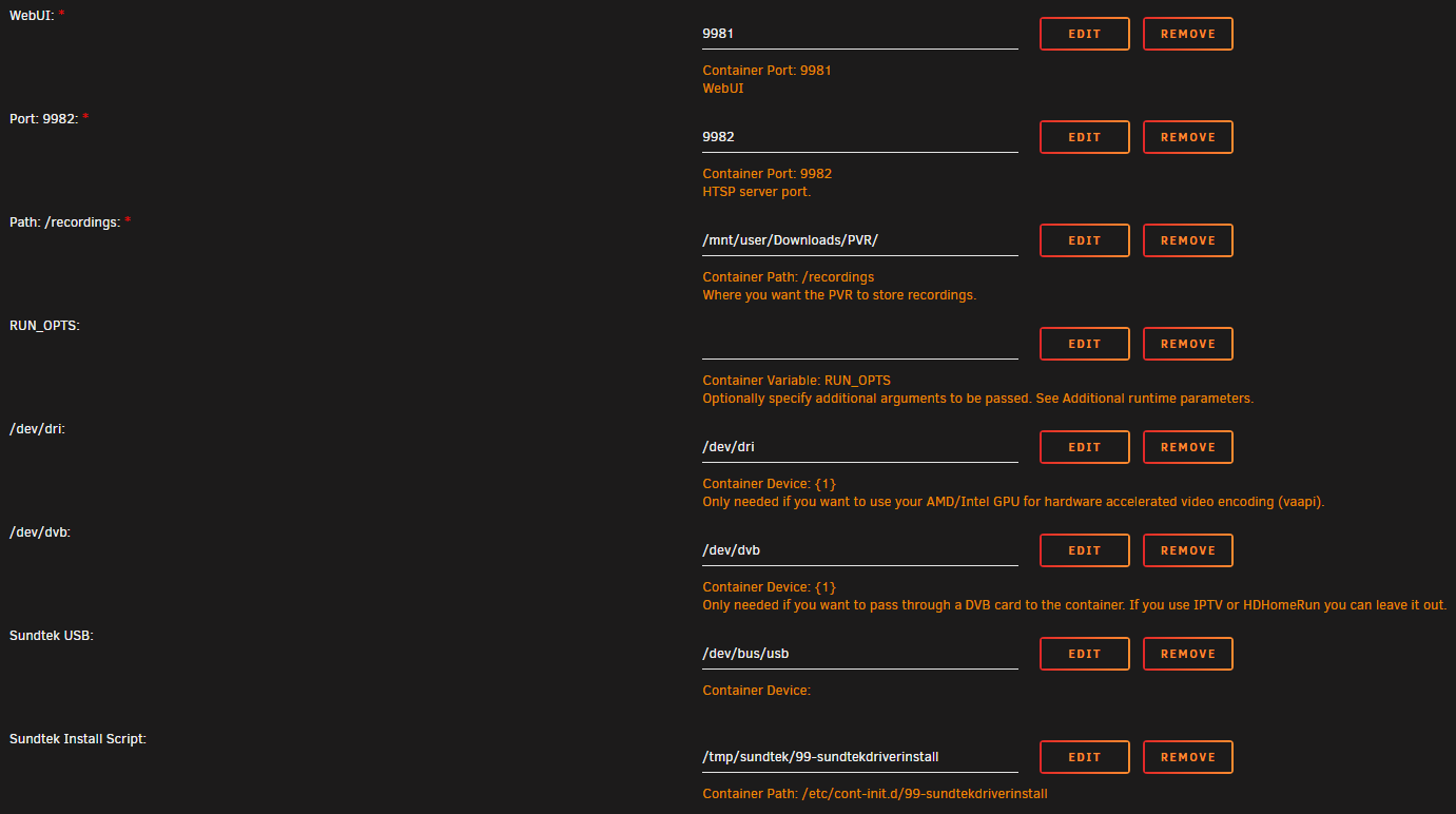

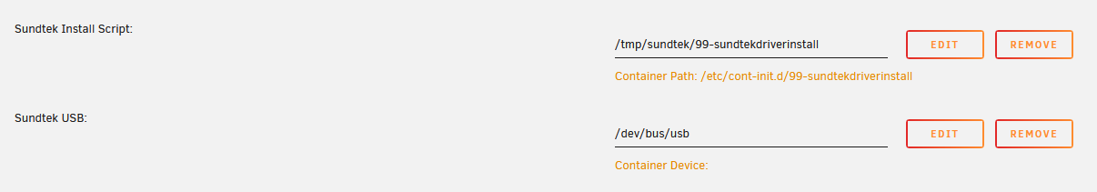

Are you also sure that you are using the Linuxserver.io version from the container?
What have you done on the plugin page?
Can you share your Diagnostics again please?
I think the driver is not installed correctly on your system.
If you follow the directions from the plugin page and install it to the container everything should work fine.

Yes same adapter and using lsio. I will give it a try again and share diagnostics.
Sent from my SM-G991B using Tapatalk

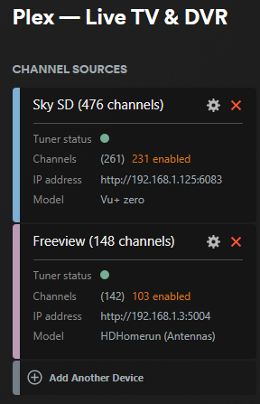

and if my magic its working again, not sure if its because I still had binhex container and I had the same settings in there but that was stopped.
Either way now have my sundtek showing up as freeview and my old vu+ zero for freesat in plex
