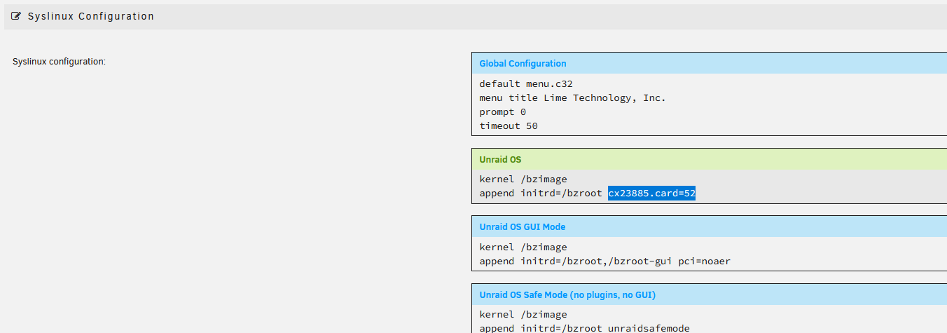

I was wondering if you could steer me in the right direction for getting my WinTV-HVR5525 working.  It's a brand new board, direct from Hauppauge.  Initially it wouldn't detect at all (syslog showed cx23885 not recognising it) so I forced detection with
rmmod cx23885
modprobe cx23885 card=52
and get this output in the logs:
Spoiler
Jun 30 15:24:38 servermonkey3 kernel: cx23885: cx23885 driver version 0.0.4 loaded
Jun 30 15:24:38 servermonkey3 kernel: cx23885: CORE cx23885[0]: subsystem: 0070:f039, board: Hauppauge WinTV-HVR5525 [card=52,insmod option]
Jun 30 15:24:38 servermonkey3 kernel: tveeprom: Hauppauge model 150339, rev C6I6, serial# 4036192849
Jun 30 15:24:38 servermonkey3 kernel: tveeprom: MAC address is 00:0d:fe:93:6a:51
Jun 30 15:24:38 servermonkey3 kernel: tveeprom: tuner model is SiLabs Si2157 (idx 186, type 4)
Jun 30 15:24:38 servermonkey3 kernel: tveeprom: TV standards PAL(B/G) PAL(I) SECAM(L/L') PAL(D/D1/K) ATSC/DVB Digital (eeprom 0xf4)
Jun 30 15:24:38 servermonkey3 kernel: tveeprom: audio processor is CX23888 (idx 40)
Jun 30 15:24:38 servermonkey3 kernel: tveeprom: decoder processor is CX23888 (idx 34)

EDIT: Because I've saw it, please remove your entry from the go file and instead add this line to your syslinux.config:
cx23885.card=52
This is a bit more user friendly.
Should look something like that:

[Edit 2] Just saw your syslinux note and have amended accordingly.  Feels much better than having it probe, fail, I unload, then reprobe so ta!
