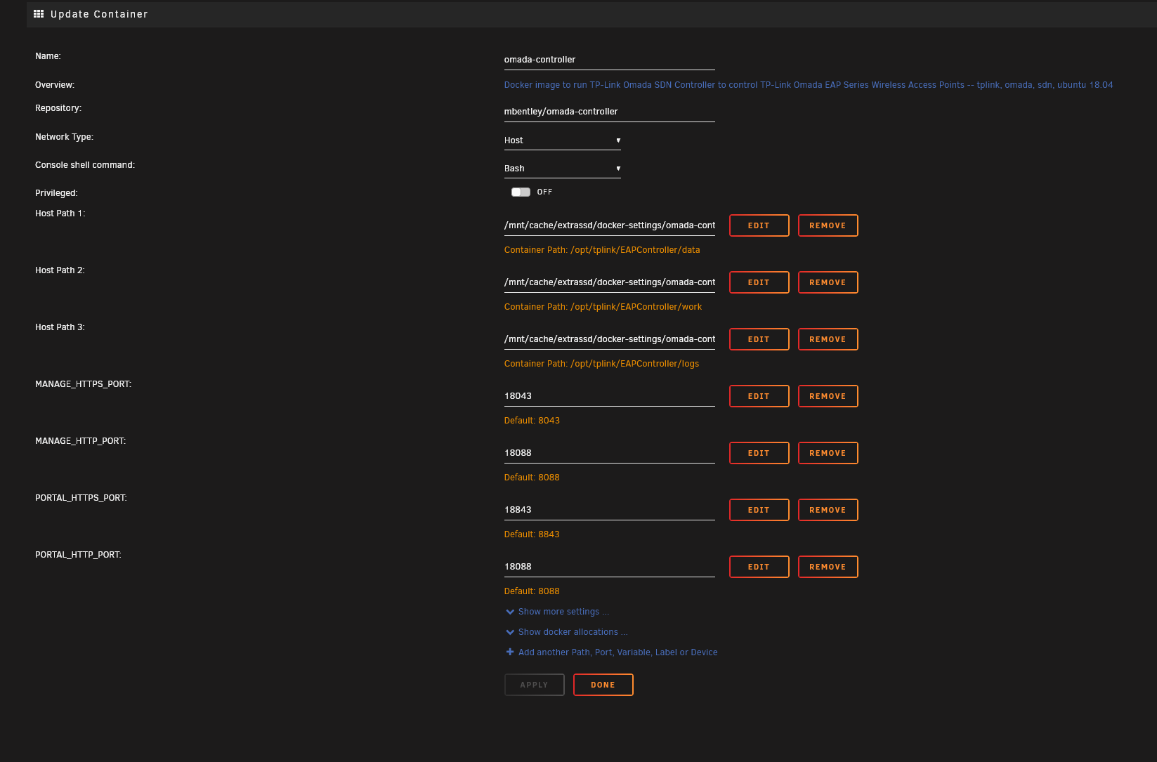

I don't know what to say to that. "Probably"? The only thing I know is that I have the docker running since a year, updated the controller several times in the meantime and never had this problem before. So, where does this leave me now?
@LotF and you take a screenshot or tell us where the file paths are pointed on your docker template?
I believe there are three paths that all need to be proper file paths on your box.
I had the same problem. After I carried out the configuration again, I noticed that there were no paths for the data specified for the docker container.
Now my idea would be to stop the container, copy the data to appdata and assign this path to the container. Then start the container and hope that the data is taken over.
However, I would need to know where the container's data is currently located. How can I find out?
@olco Look around these paths... /mnt/user/appdata ... look for a "docker-settings" folder, any "omada-controller" folder.
Settings > Docker... will show "Default appdata storage location" see what that says as well.
I can see a folder for each of my docker containers in /mnt/user/appdata but none for the omada-controller.
Settings > Docker shows me Default appdata storage location: /mnt/user/appdata/

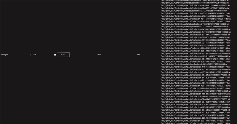

I Have a trouble with OMADA controller. It's installed on cache disk :
But I have constant  read HDD activity when OMADA is open... The open file plugin indicate omada "may prevent shutdown" ... I don't understand why:
231980
Thank you in davance
Hello @calagan57, in my opinion running your dockers on the cache drive or an unassigned drive is a good practice as it keeps some of the activity off your array that doesn't need redundancy.
I don't run the open files plugin, but it does make sense to me that the omada controller is interacting with files and keeping track of wireless clients consistently. By your screenshot it looks like plugin is seeing the mongodb files where it appears the docker is using as its database.
I have never had an issue shutting down or restarting my unraid server based on anything hanging up on any of my docker containers including omada.
If you are able you could do a test shut down and restart to see if everything cleanly exits. I believe it will based on using this container in many others for years.
I hope this is helpful.

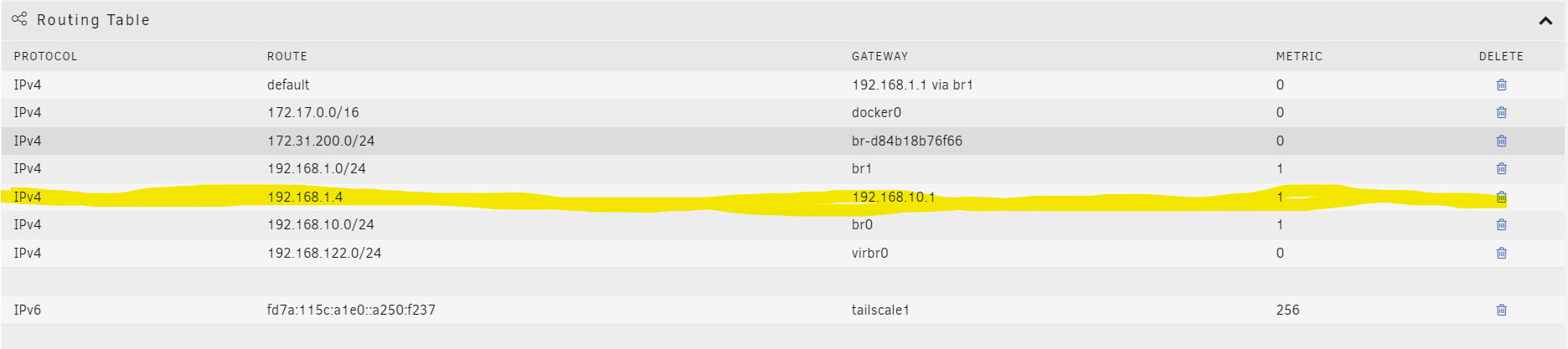

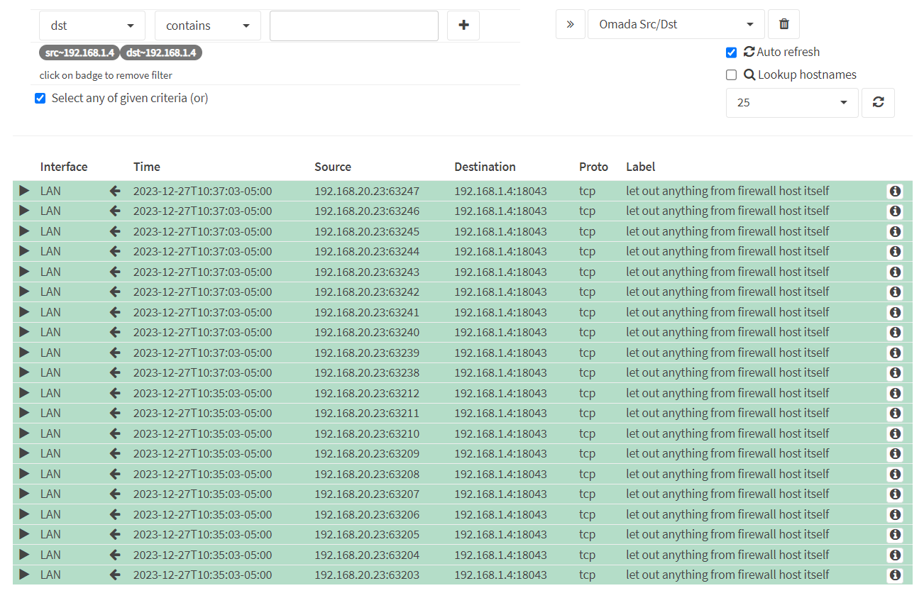

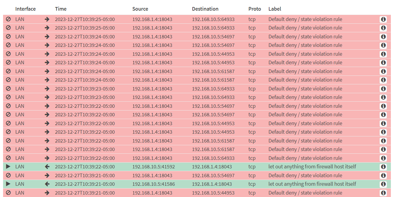

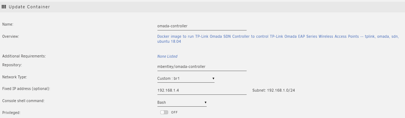

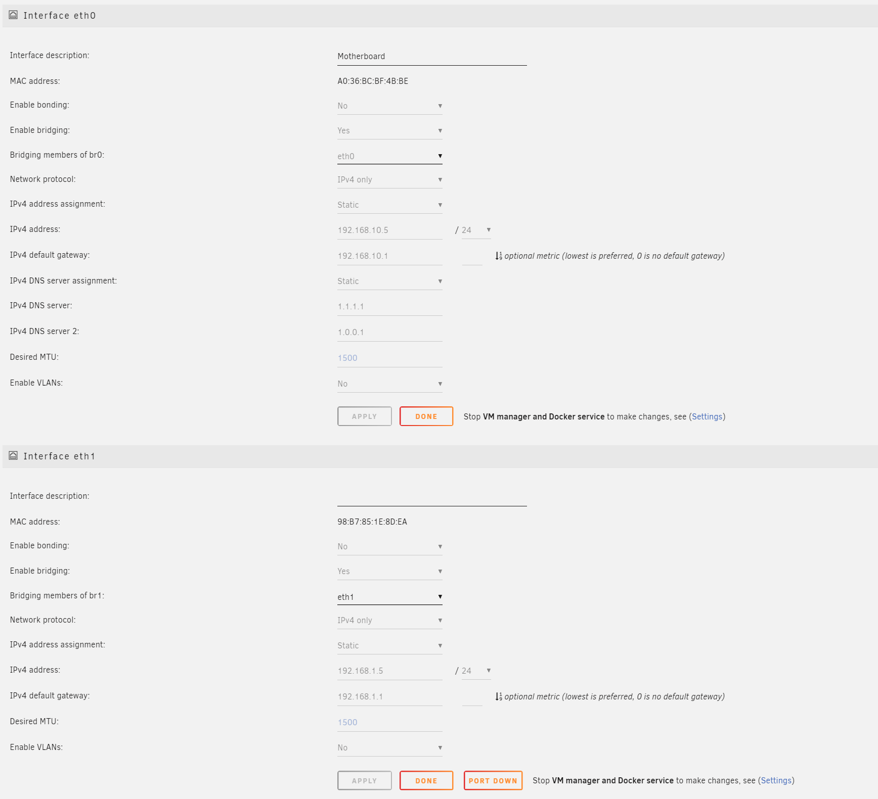

I'm running into weird routing issues with the Omada-Controller and I suspect it's because I didn't set something right in the docker network config or in Unraid.
Here's some information about my configuration
  • I have two active NICs
    • 192.168.10.0/24 - Main DMZ subnet
      • ETH0
      • Bridging enabled
      • Unraid IP: 192.168.10.5
      • All dockers except Omada use "bridge" and get assigned 192.168.10.5
    • 192.168.1.0/24 - LAN subnet which "contains" the Omada switch and AP
      • ETH1
      • Bridging enabled
      • Unraid IP: 192.168.1.5
      • Omada configured as "BR1" with static IP 192.168.1.4
  • My desktop of the USER subnet can ping and access the Omada controller just fine
  • The Omada controller controls the switch and AP fine
Unraid and all dockers couldn't ping the controller and other dockers couldn't talk to the Omada controller. I added a static route (yellow in the attached route screen capture) in the Network configuration to access 192.168.1.4/32 via the 192.168.10.1 gateway which fixed the ping issue but created a weird behavior in the firewall (see attached screen capture) and still doesn't allow any connection between dockers and Omada.
I'm guessing that using "BR1" and setting a static IP isn't the right way of achieving what I'm trying to achieve but I have no idea how to do it properly.
@OttawaClimber this one might be over my pay grade on the network side but a couple quick thoughts... If DMZ means "facing the open internet" would say that omada controller should not be in that situation.
If your APs are on the LAN that is where omada controller should be. I can't imagine a need for it to be anywhere that the APs are not, this is an internal network service. So maybe knowing what the IP addresses of your APs are can clear this up.
@hedrinbc DMZ subnet in my network is for all the services provided by the server (essentially Unraid and all dockers except Omada). From the Internet, only ports 80 and 443 are allowed through and they are forwarded to the reverse proxy.
Omada is indeed on the LAN which is where the router/firewall, AP and switch also reside.
This is essentially the reason I ran into this issue. I wanted to have the LAN (network HW + controller) segregated from the other services so I can protect the network devices from everything that doesn't have a valid reason to be accessing them.
