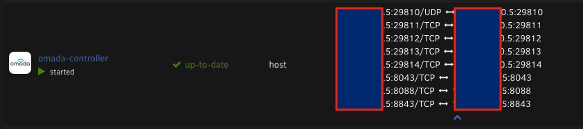

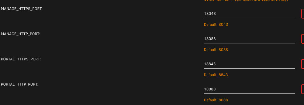

I also have a problem with setting up this container. The problem in my case appears to be with ports not paths.
For the world I am unable to change the port settings.
Even though the ports in Edit appear to be set properly and don't interfere with other container ports:
After saving the config, the container sets the ports on its own regardless of the settings I made:
I cant use above ports for omada (8043, 8088, 8043) as I use it for a different container and don't want to mess things up with that other container.
This is the first instance I see such behaviour with the container, where editing the ports does not have any effect on actual changes to container. Usually the workaround I used was to change network type from host to bridge, but in bridge mode omada webui mode is not available;(
I also tried to delete the default ports in the container which use Variable config type, and set it as Ports (instead of Variable) - still no joy;(
Any ideas on how to force the port change?
Btw, when I turn off the other container, omada works great, so its not the paths config issue, but ports in my case.

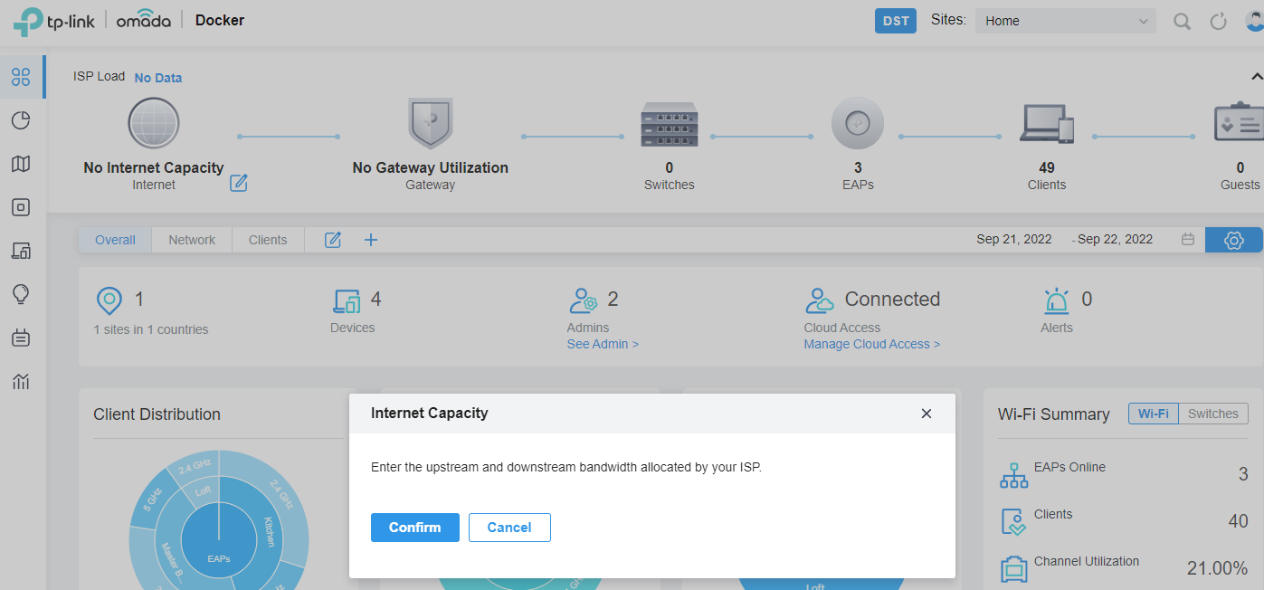

The internet capacity input box doesn't show up for me. It's been like this for months. I've tried different browsers, different computers.

4 minutes ago, Skidmark said:
The container's default path for it's data, logs, etc begins with "/mnt/disks".  in unraid this directory doesn't exist
/mnt/disks is created by Unassigned Devices plugin, whether that is the path needed depends
Is /mnt/disks/extrassd/docker-settings/omada-controller the expected location for the container to use?  At least on my machine, that directory wouldn't persist after a reboot.
My setup:
Path in container <--> Path on host OS
/opt/tplink/EAPController/data  <--> /mnt/cache/appdata/omada-controller/data/
/opt/tplink/EAPController/work <--> /mnt/cache/appdata/omada-controller/work/
/opt/tplink/EAPController/logs <--> /mnt/cache/appdata/omada-controller/logs/
