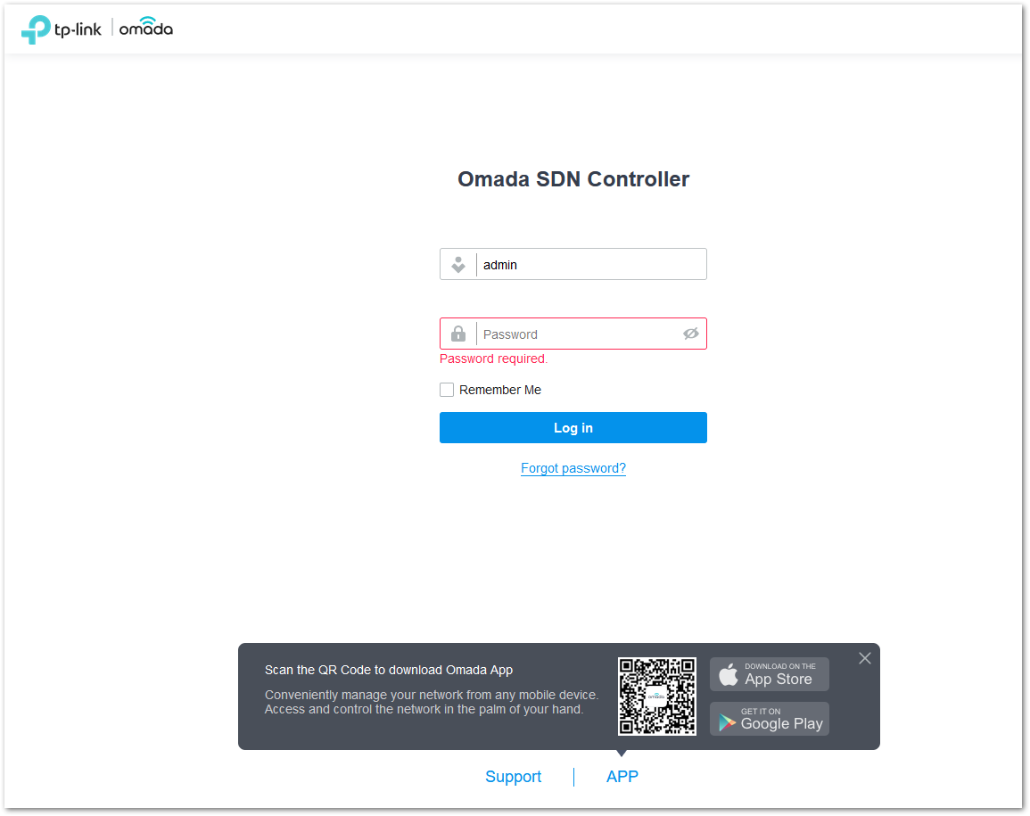

Hello together,
my omada controller loses the Login Credentials after running the setup wizard, Any Idea or experience with this problem?
I am sure, that i used the right login and passwd

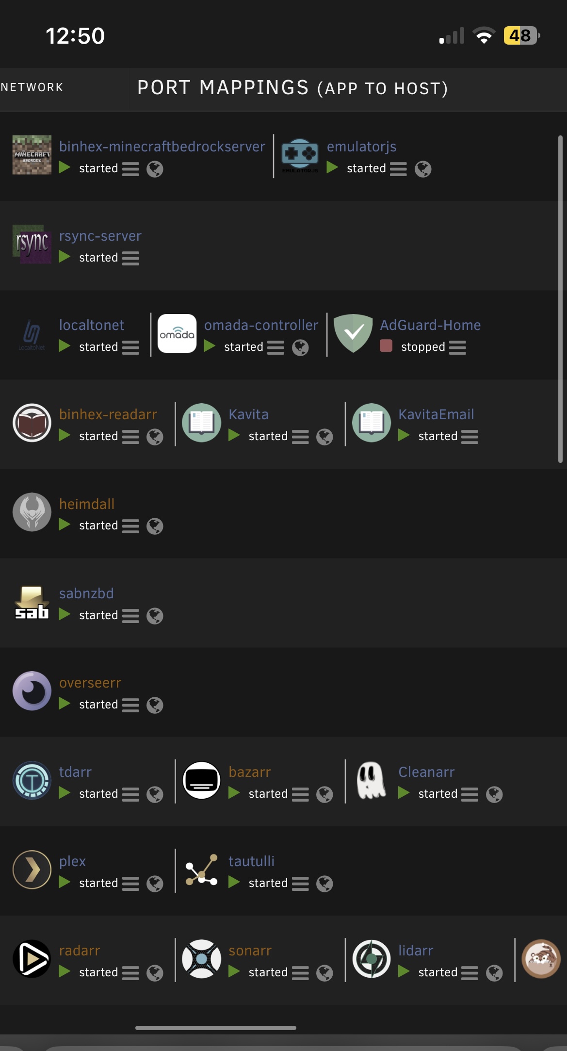

Ok, gonna show what is quite possibly my stupidity here. I’ve installed the container with default template, I didn’t change anything. When I try to go to the webui, I get a “cannot connect to server”. Did I miss some required change to the template or something else perhaps. Also, after some time the container appears to be stopping itself. I’ve removed and redownloaded once already with no fix. Any ideas? Thanks in advance.
Check your MANAGE_HTTP_PORT / MANAGE_HTTPS_PORT variables on the omada-controller container and make sure that's the port you're connecting to (http:// or https:// respectively)
