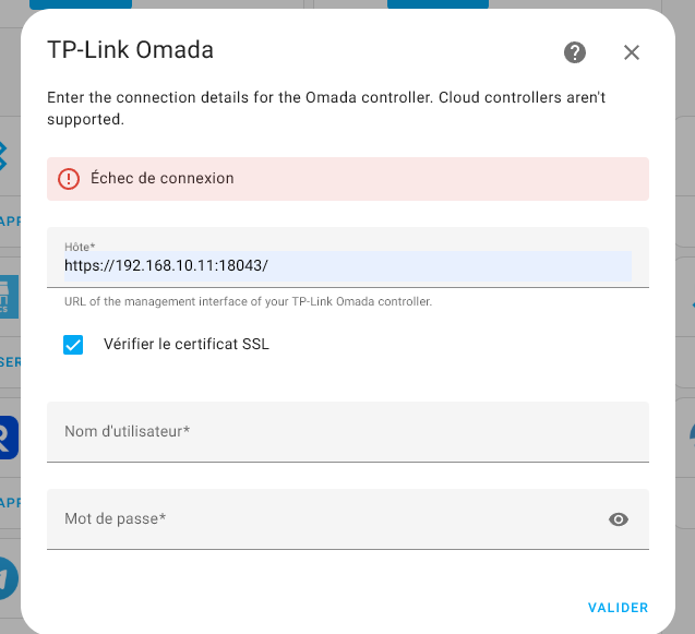

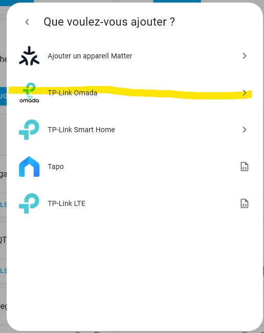

Hello!
sorry  for my bad english...
I have omada controller docker work well on UNraid ;-)
Now I'm  trying to integrate omada to Home assistant. But whend I  configure acces I have some error connection. My user/pwd are ok ;-)
image.png.260ce45203f0a3981015a7ae9e031c3f.pngimage.png.1454470cdc30a8d9995bb3b733cac56c.png
Is it possible it's a problem with https ? Because when I'm connect via chrome https not working:
Any idea?
Thank you!

15 minutes ago, calagan57 said:
Hello!
Any idea?
Thank you!
I have the Omada integration within HA working. Have you tried unchecking the SSL checkbox?
Thank you!
I made this :
I have tried many choice (with or not https,...)
but I still have error (uncheck box appaer again with the error:
But I have an error https when I'm connect to omada with  browser like this:
Can I desactivate https on unraid/omada or configure https ?
Thank you!
37 minutes ago, calagan57 said:
Thank you!
I made this :
Thank you!
Did you try the entering just the IP address and port number, without http://?
