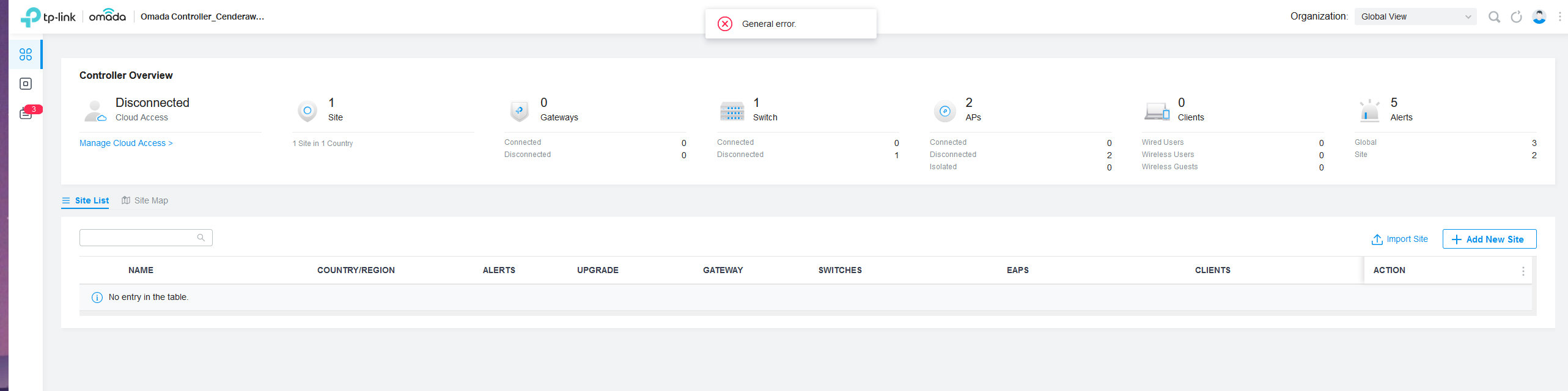

Since an update today I cannot log into the controller anymore. Does anybody else have that problem? I am very sure that I am using the correct credentials.
Yes, others are reporting the same.  I created an issue on the TP-Link forums: https://community.tp-link.com/en/business/forum/topic/623942?replyId=1258164 and there is a discussion tracking it on the image GitHub: https://github.com/mbentley/docker-omada-controller/issues/342.  People are also posting about it on Reddit: https://www.reddit.com/r/TPLink_Omada/comments/16rb07h/admin_login_doesnt_work_after_updating_to_latest/
It doesn't seem to be happening to everyone though so that's the odd part.
Edited by mbentley

Hi all,
does anybody else has issues after todays docker update?
All devices are hanging in "Adopting" state 😰
Was everything working like a charm since weeks and after last updates...
Br
Dino
Edit: seems like all Settings are vanished??
Edited by dinomyte
1 hour ago, dinomyte said:
Hi all,
Br
Dino
yeah. i'm having the same issue. main page showing general error as well
Sorry about that - an issue with a new experimental feature to allow users to make the MongoDB work from another container or host accidentally broke the connection to the MongoDB that the controller spins up.  I forgot to add a default connection string but it should be fixed now.
Fixed! Thanks a lot for your fast support!!!
Edited by dinomyte
Unbelievable. thank you mbentley. I thought I was going crazy. I've literally trying to setup brand new switch this morning that arrived today and couldnt figure why it wouldnt adopt! Talk about timing.
