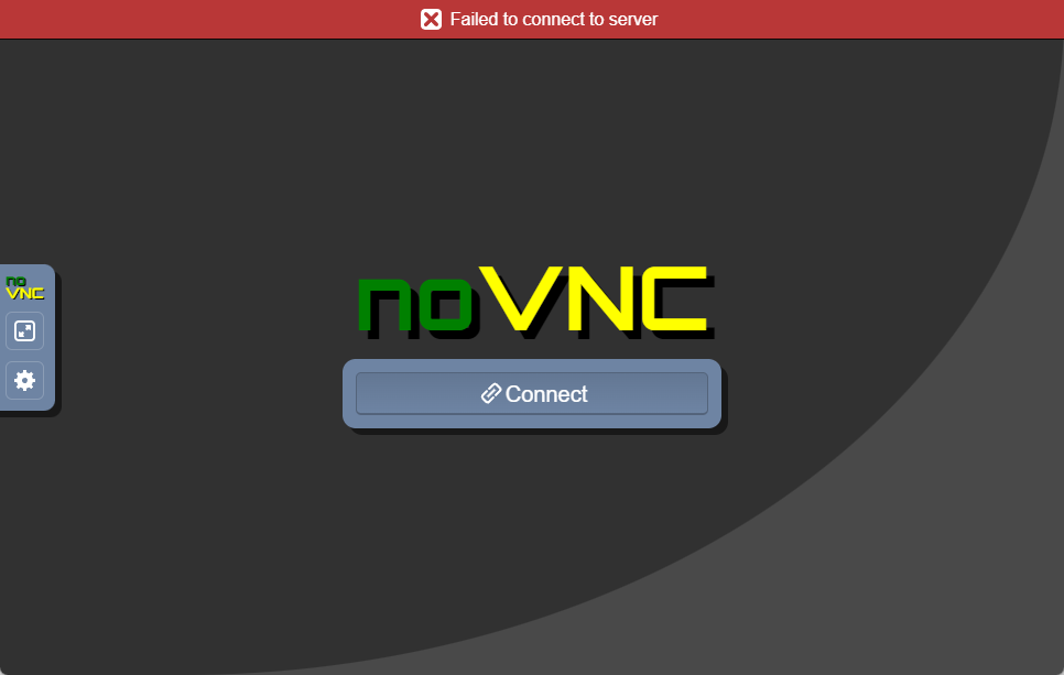

Hey all, Just upgraded from 6.9.2 to 6.10.0 and my VMs VNC no longer connects.
As far as I know, I'm using default settings, but both of my VMs VNC worked pre-update, and they both don't work post update. The VMs themselves are working, as I can ssh into them, but the VNC itself just loads a failed to connect (Screenshot & diagnostics attached).
Looks like there might be some related logs in the syslog - which if I'm correlating to the system/urls.txt file correctly, I imagine this is the cause
