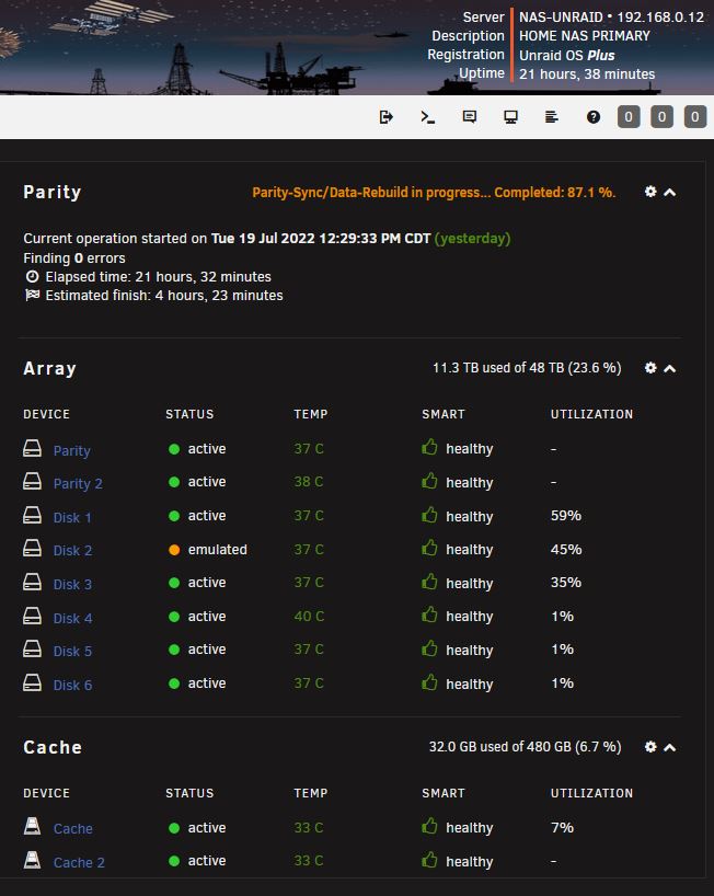

  16. Let me see if I got this right. On my share before transferring the 1TB my settings was Yes : Cache for that new share. But when it hit the max of 500GB of my cache everything crashed and my GUI blew off. For sure I've seen some errors in my IPMI console about the cache full or something like that, so it did not spill over to the array. Is that because I had nothing set under the Main -> Pool Device -> Cache -> Minimum free space: 0 ? I have a backup UnRaid and will do a test, because this entire experience hosed my system and ain't good I really appreciate the support and guidance
  17. Well when I go to Main and under cache settings and I look at the help menu I get this which is conflict with your statement? Minimum free space: "This defines a "floor" for the amount of free space remaining in the volume. If the free space becomes less than this value, then new files written via user shares will fail with "not enough space" error." No mention of bypass cache and write directly to array? Am I looking at the right settings? Am
  18. Thank you Sir. I looked at all my docker containers and they all have paths to a /mnt storage point so I should be covered. Now on the cache issue, how does it work? My share was set to use cache for new files, but the size of the transferred files (1TB) was bigger than the cache (500GB). So when it hits 500GB what does it happen. That's where my crash happened. Is either the way the cache behaved or it may be something with the "DirSyncPro" app I used?
  19. Thanks much. I will clean the shares configs after this. For sure it was filling rootfs as I seen some rootfs errors on my IPMI console, so that's it. So after the parity is done I just rebuild disk 2? - Stop the array - Set the disk2 to be not installed - Start the array - Stop the array - Set the disk2 to be the appropriate disk - Start the array - unRaid will now commence the rebuild operation.
  20. Yes that was the df -h after the reboot Ok here is the history to what happened and I am sure it was related. - I created a new share to prep a 1TB transfer from an external SSD drive. I said "Yes to Use cache pool (for new files/directories)" - Plugged in the SSD drive and start the transfer for the 1TB - It looks like my cache drive is only 500GB so at some point during the transfer something happened, cache drive got full, and I started having these dynamix errors and GUI crashed. - I did a command line reboot, it came back and started parity check. During parity check the move script was trying to move from cache to the new share. It did finish moving whatever was on cache, about 480GB. Now cache drive is empty. - I got the dynamix errors again during the parity check, GUI was messed up, I managed to stop and reboot. When back online, disk 2 was disabled. - I uninstalled all my dynamix plugins for now, so my GUI stop crashing. - Now I started a parity check again. I hope after parity check I can rebuild this disk? Data is all there I guess emulated? What course should I take? Wait for parity check to finish, hopefully no errors and then do a disk rebuild? Is it possible my parity got messed up during the unsuccessful transfer from the 1TB SSD drive? Attached diagnostic. nas-unraid-diagnostics-20220717-1937.zip

  22. Talking about timing. Right in middle of a parity check and GUI decided to go south on me The good news parity is still running in the background. Any way that I can restart the GUI or just wait for the parity to be over and reboot command line? I am on 6.9.2 by the way And what could cause this GUI crash? see attached pic And get this in syslog: root@NAS-UNRAID:/var/log# tail -f syslog Jul 17 18:51:38 NAS-UNRAID root: error: /webGui/include/DashUpdate.php: uninitialized csrf_token Jul 17 18:51:38 NAS-UNRAID root: error: /webGui/include/DashUpdate.php: uninitialized csrf_token Jul 17 18:51:41 NAS-UNRAID root: error: /webGui/include/DashUpdate.php: uninitialized csrf_token Jul 17 18:51:46 NAS-UNRAID root: error: /webGui/include/DashUpdate.php: uninitialized csrf_token Jul 17 18:51:46 NAS-UNRAID root: error: /webGui/include/DashUpdate.php: uninitialized csrf_token Jul 17 18:51:46 NAS-UNRAID root: error: /webGui/include/DashUpdate.php: uninitialized csrf_token Jul 17 18:51:51 NAS-UNRAID root: error: /webGui/include/DashUpdate.php: uninitialized csrf_token Jul 17 18:51:53 NAS-UNRAID root: error: /webGui/include/DashUpdate.php: uninitialized csrf_token Jul 17 18:51:53 NAS-UNRAID root: error: /webGui/include/DashUpdate.php: uninitialized csrf_token Jul 17 18:51:56 NAS-UNRAID root: error: /webGui/include/DashUpdate.php: uninitialized csrf_token
