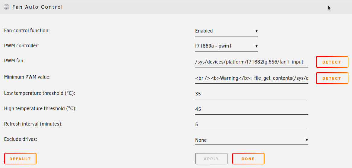

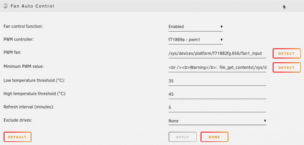

I'm talking about fan control from UnRAID. I attached a monitor to switch the boot order but now never see the BIOS. However, I noticed this morning that the speed for Fan 0 seems to be being reported on the Dashboard and fan control is apparently in the hands of Autofan v.1.6 thanks to the F71691a module I had tried (I thought unsuccessfully) to load. All is not well, here, though, as only one fan is reported and the detection of the minimum PWM value produces a line of HTML warning which looks like an uncaught exception. -- Chris
