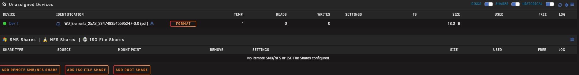

Apologies for the delay. See attached diagnostic and screenshot. thenas-diagnostics-20220623-1943.zip
It's just a single NTFS "Basic Data Partition".
Hi there, I'm having issue with an external USB HDD. I plug it in and it appears in unassigned devices, but I'm unable to mount the drive. It only has the format option. I know the drive is fine because I can access the data when I plug it into my Windows machine. My current work around it to pass it through to a VM in Unraid. Disk log below. kernel: sd 15:0:0:0: [sdl] Very big device. Trying to use READ CAPACITY(16). kernel: sd 15:0:0:0: [sdl] 35156590592 512-byte logical blocks: (18.0 TB/16.4 TiB) kernel: sd 15:0:0:0: [sdl] 4096-byte physical blocks kernel: sd 15:0:0:0: [sdl] Write Protect is off kernel: sd 15:0:0:0: [sdl] Mode Sense: 47 00 10 08 kernel: sd 15:0:0:0: [sdl] No Caching mode page found kernel: sd 15:0:0:0: [sdl] Assuming drive cache: write through kernel: sd 15:0:0:0: [sdl] Attached SCSI disk emhttpd: WD_Elements_25A3_546456468464654-0:0 (sdl) 512 35156590592 emhttpd: read SMART /dev/sdl
