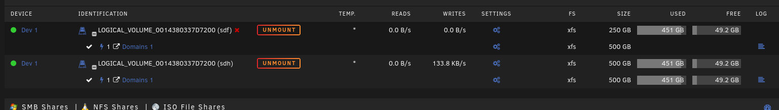

  5. I just updated UD. I'm not sure why it shows DEV1 for both drives on the main screen. When I click DEV 1 for the first drive it shows: dev2 Settings Name: Dev 2 Identification: LOGICAL_VOLUME_0014380337D7200_3600508b1001cf95ff760c0e4274362fa (sdf) Then when I click the second DEV 1 dev1 Settings Name: Dev 1 Identification: LOGICAL_VOLUME_0014380337D7200_3600508b1001c9d70bb2587130140cdbf (sdh) I have unmounted, remounted, formatted, etc the 250GB drive a few times, I've removed it and attached it to a Linux box and confirmed it works. Let me know what other information you might need its quite confusing. tower-diagnostics-20220215-1307.zip
  6. I searched this thread a bit but its quite deep. I have a HP server box using a raid controller unfortunately. I have a 4 disk array with its 1 parity drive and 2 SSD's I use 1 for VM's and I am attempting to use the other for a cache drive. In the raid controller i have each SSD setup as an individual Raid0 Confg (same as my array), but when the drives show up in UD they join themselves together and show incorrectly. I was wondering if there is a way I can get the drives to show independently just like every other drive in my system.
  7. Makes sense. What doesn't make sense is why is it only the SSD's and all the other drives in the array work as anticipated. Thanks
  8. Will do. The more I look at it though its Unraid/UM issue not using the whole volume ID. I agree on the raidcontroller issue but this is the only Drive in my whole setup that has this issue, both Samsung SSD's. The other 6 drives are fine.
  9. when i look at the dev settings they have clearly different ids, is this a truncation problem with UD? LOGICAL_VOLUME_0014380337D7200_3600508b1001c9d70bb2587130140cdbf (sdh) LOGICAL_VOLUME_0014380337D7200_3600508b1001cf95ff760c0e4274362fa (sdf) so they have different serials right? Unraid is just seeing them as the same UUID? Is t hat the correct terminology?
  10. Is there a way to change the id, they are two physically different drives.
  11. Just did some work on this over the weekend and I recall what I did. So when I install the second SSD that I was using for a cache (primary for VM's) Unraid shows both Devices as Dev 1 and seems to lump them together. Which is a bit confusing, in the HP bios I have each drive setup as a individual raid 0 in the same manner I have my whole array setup but the two SSD's for some reason show the same UUID. Unraid shows them as sdf and sdh but the Id's are the same, is this whats causing the problem? Any thoughts?
