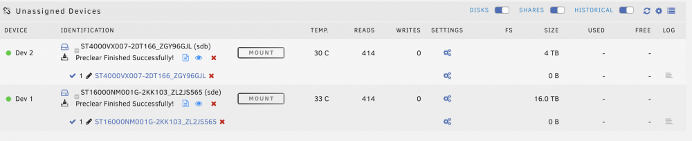

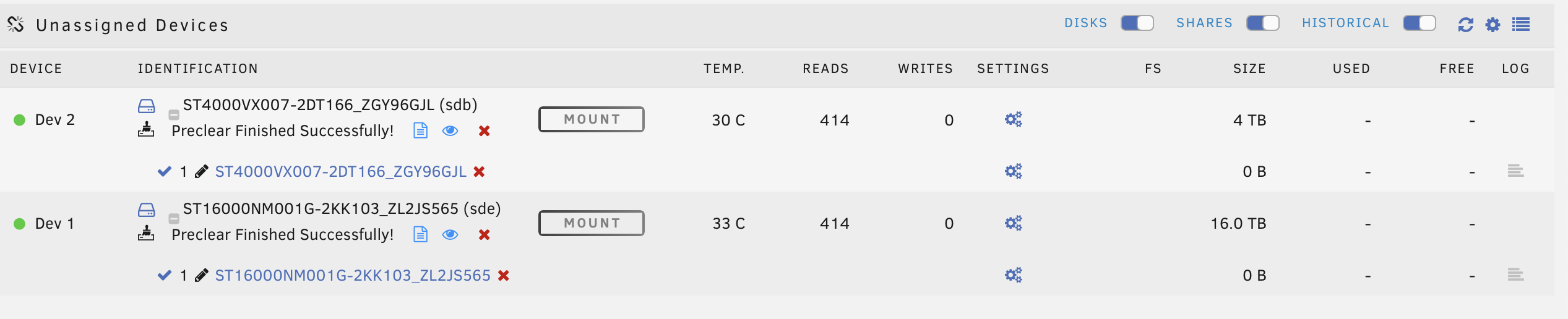

I am trying to use a hard drive for CCTV storage and therefore do NOT want it on the array being parity written. the drive has been pre-cleared and shows up in unassigned devices as completed preclear. mount is greyed out and I can't figure out how to format or use this disk. I need to be able to pass to docker or potentially VM for my CCTV system. Destructive mode is turned on in UD options.
