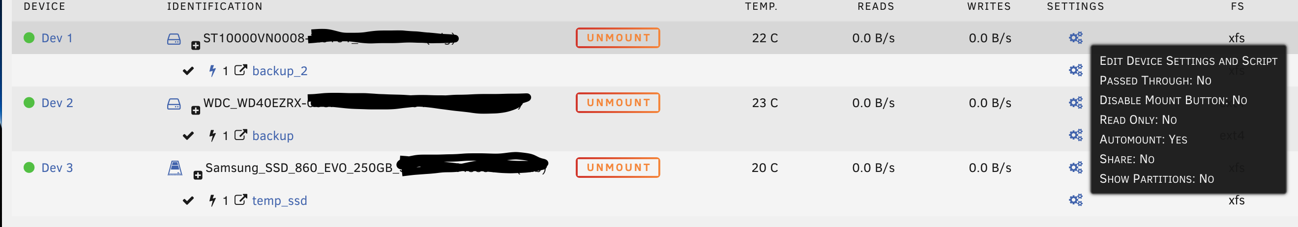

  6. I cant hide the partions anymore, when i click the "+" it will hide, but some seconds later it's open again. Any hints? Newest UD and Unraid installed.
