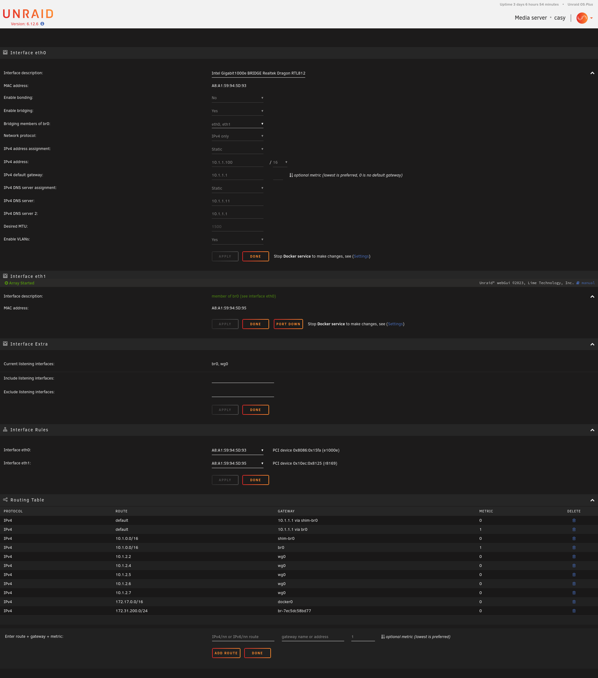

i had the wireguard setup and running for a long time now i had to change the nic assignment due network restructuring there are 2 nics, 1. from intel and 2. from realtek MAC adresses are totally different after swapping unraid list 2 macs which are near neighbours the two nics are and were set to use bridge mode after swapping the eth0 with eth1 the vpn is no longer working i expected this to be an issue with the router, so i have resetted the config completly and reconfigured it again. as this does not help, it has to be something related with the nic swap. i would be glad if there is help or an idea how to fix that. Best regards casy-diagnostics-20240207-0250.zip
