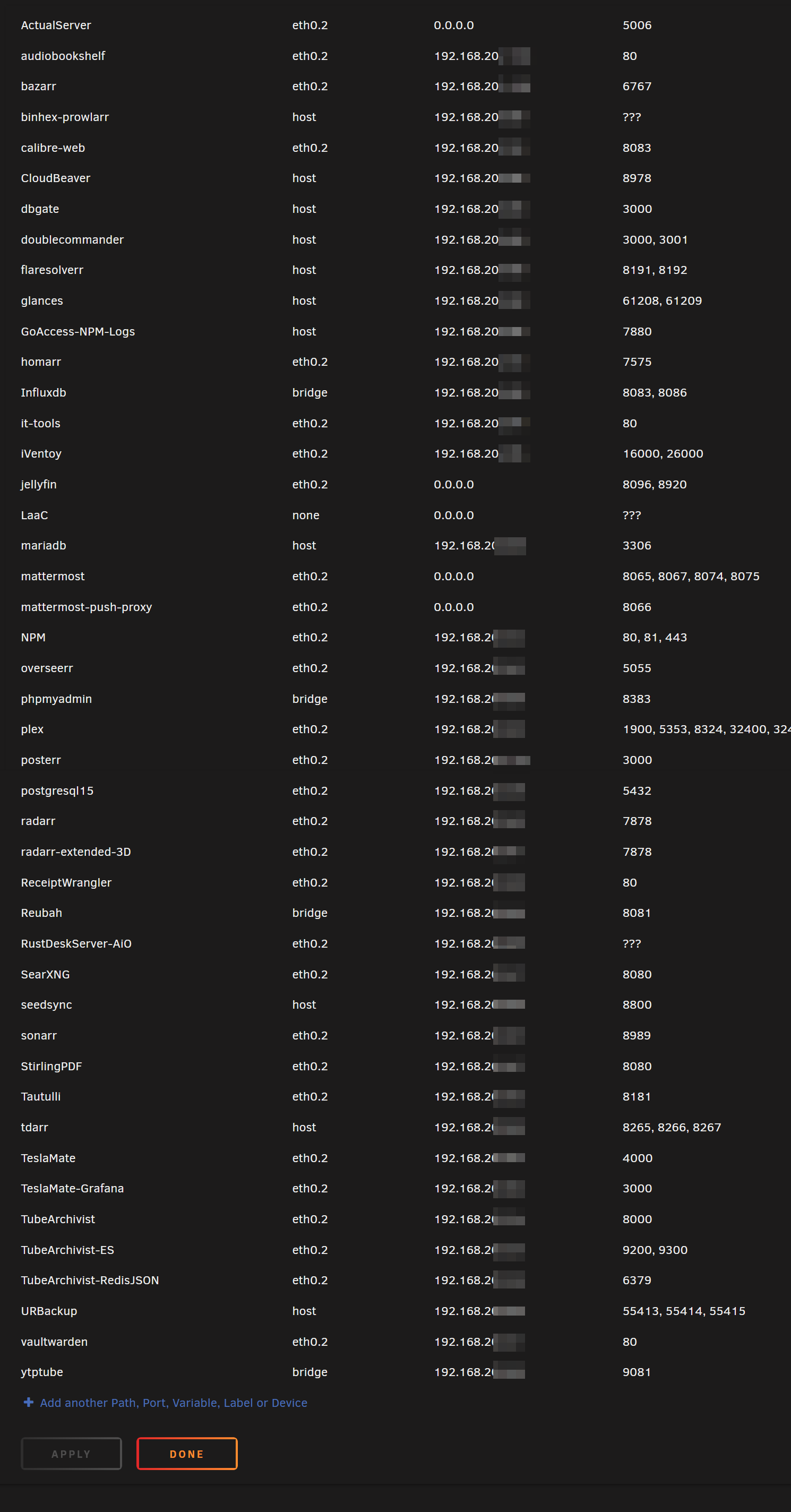

  19. I may be in the minority, but I assign IPs to each container on a dedicated Docker VLAN. The challenge the Unraid UI poses is that it doesn't present the allocation table in an organized way. Over a year ago, I posted a feature request to group/sort the containers by network and list them in numerical order by IP address or allow for sorting by IP or ports. That hasn't happened yet, so things are still currently sorted alphabetically by container name. Has anyone found or made a plugin/addon/script that can query the system for all of the allocations and list them out neatly?
