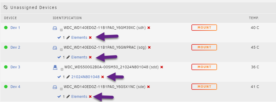

[6.10.1] New UNRAID Set Up - Drives appear in UNASSIGNED DEVICES but do not show up in PRECLEAR?
These new drives have some kind of partitions on them. Remove them and then they will appear in PRECLEAR.
Hello, I'm setting up a new UNRAID and I'm new to this. I've searched Google and the forums but couldn't find a solution for this. My devices show up and appear just fine / working in the MAIN > UNASSIGNED DEVICES section. However, they do not appear / not showing up in the UNASSIGNED DEVICES PRECLEAR plugin? This is a fresh install, so I have no arrays set up. These are brand new, shucked drives. Any ideas?
