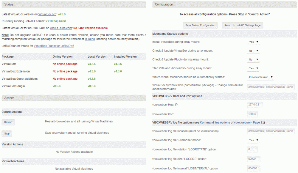

  1. peter_sm, They are not just temporary files. When moving this symlink in my plugin I also move the files to the new location. BillyJ, please post your syslog and virtualbox.cfg

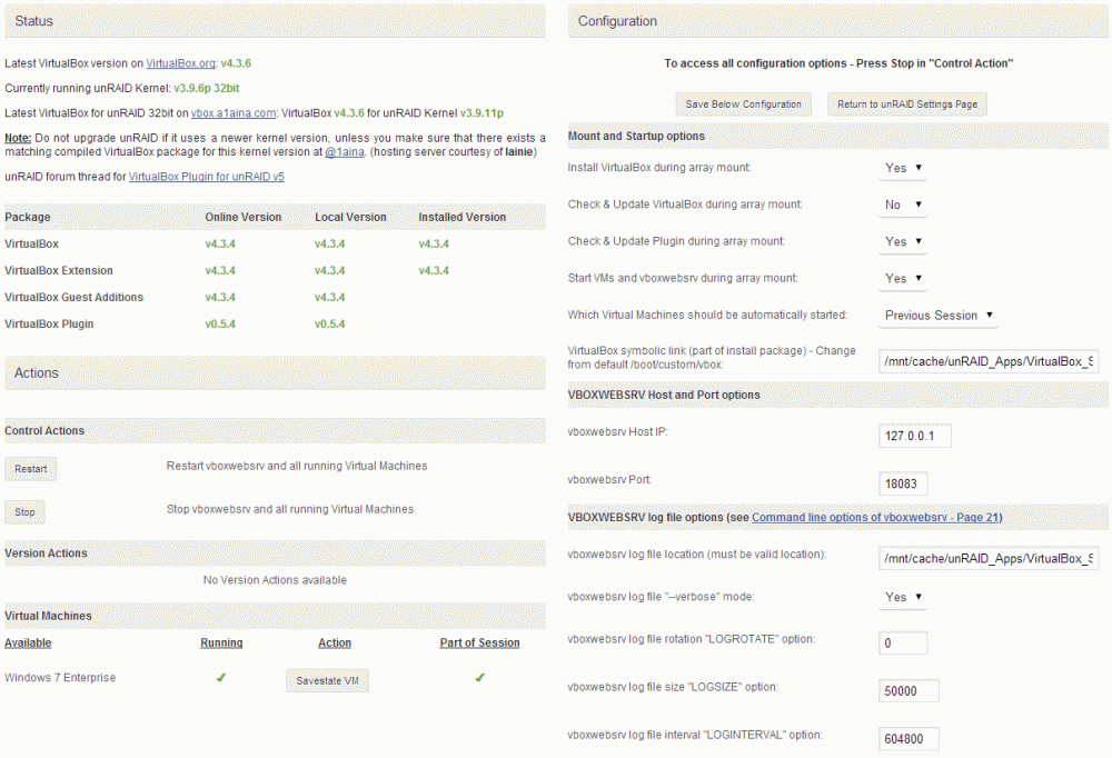

  2. New version: 0.5 - Added option to download GuestAdditions Package - Added option to change /boot/custom/vbox to different location including moving of files - Changed configuration update code I added the option of downloading Guest Additions package so you don't have to look for it online. Changing the /boot/custom/vbox to a different location was requested so that there will not be any writing to the flash drive by VirtualBox.

  9. I can maybe add a parameter to the plugin configuration that you could change /boot/custom/vbox location and it will change the symlink from existing to anything the user wants and even move existing files to the new location. I just need to understand when this location is used so I change it after every install in time.

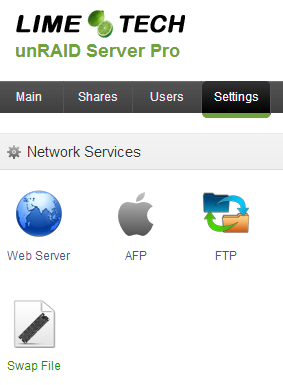

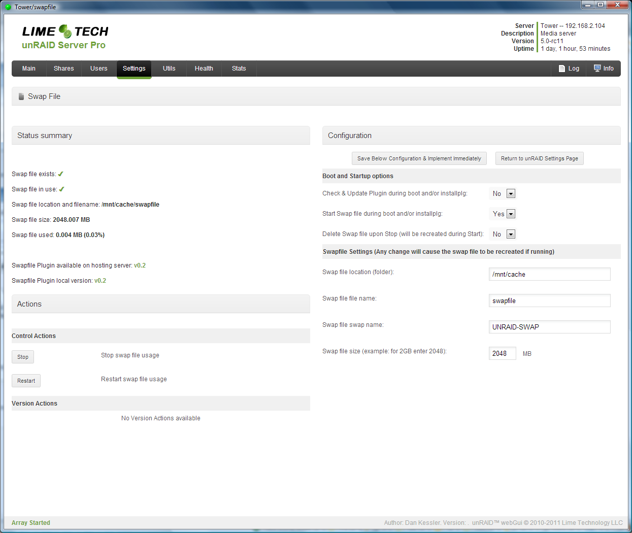

  18. From testing done here: http://lime-technology.com/forum/index.php?topic=23515.0 It seems OK to keep previous file - I added the option if future problems occur. The option to enable the swapfile upon mount should usually be set to "YES" unless you don't want to automatically use a swap file.
