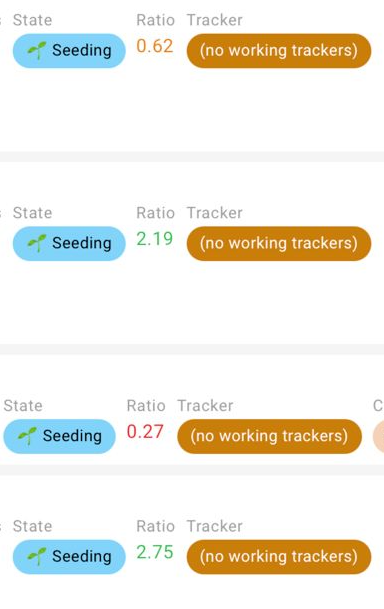

Hey @binhex. Thanks for noticing my question. Well, with over 3000 torrents already in the client, adding a new, deluge needs aprox. from 5 to 15 minutes to wait, and then it starts to downloading. And as what I have heard, 1.2.x version of libtorrent doesn't cause such problems. Screen below now has the status "seeding", but normally the inscription says "stalled" and the trackers remained unchanged.
