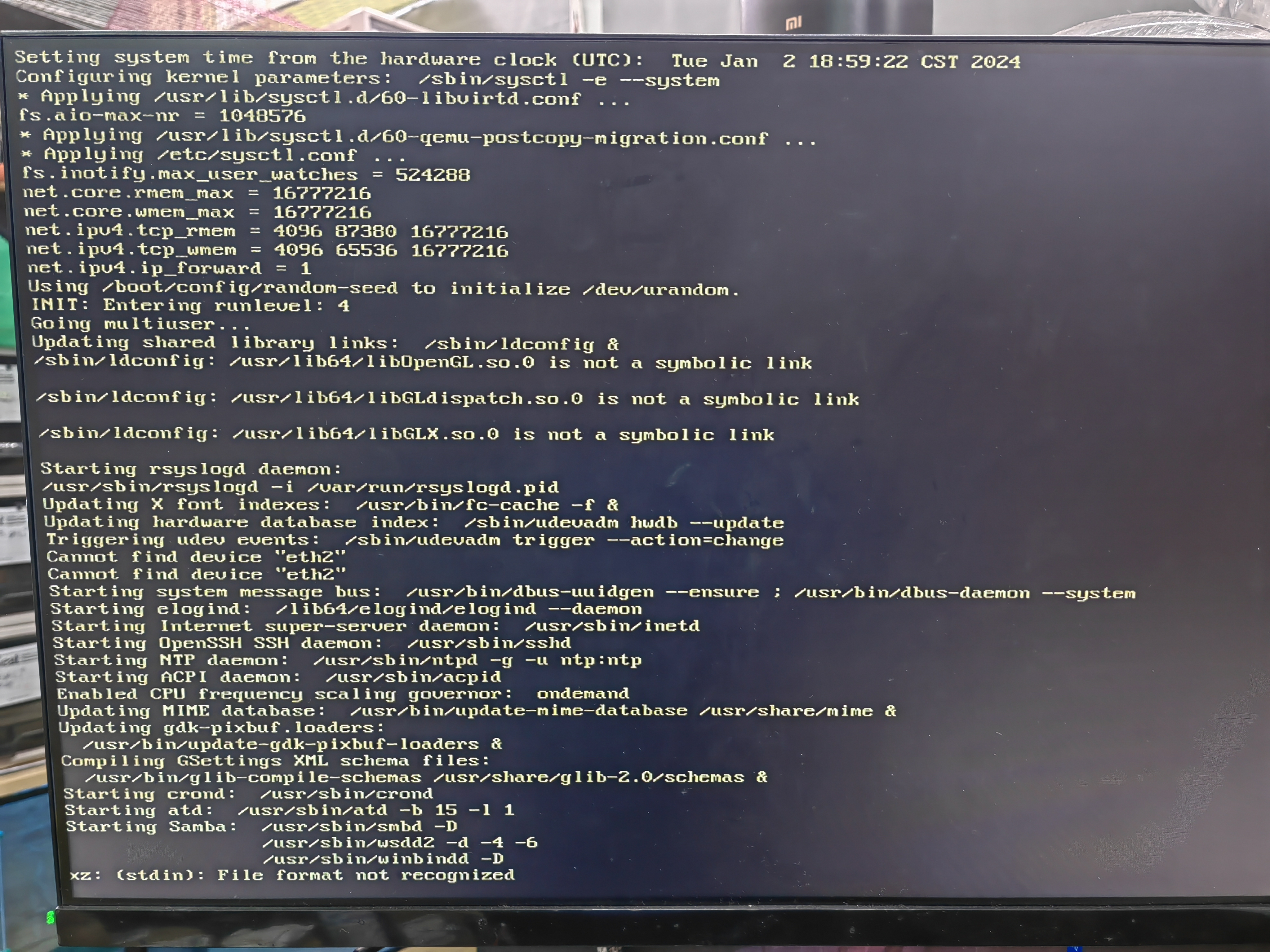

Connection Refused on WebUI, JUST Updated to 6.12.6 from 6.12.4
Thanks, it worked after another hour's waiting, but seems GUI mode is broken, no outputs on the monitor I'll try to live with that, see if upgrading drivers would help
Chrome on original WebUI address shows: ERR_CONNECTION_REFUSED When I reboot my device and choose the GUI mode, the screen stucks at: All I have done is click the Update in the Notification and Followed instructions on the pop-up window, which told me to safely restart when I see the notification, and I did The System Reboot window counted to 1800s and the device still didn't respond, so I forced a restart through IPMI and the device is now in current situation.
