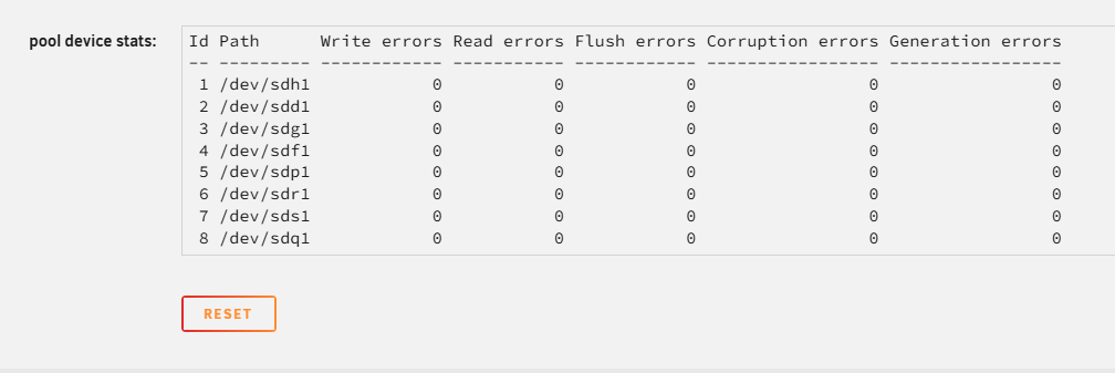

cache pool errors
Device is still dropping. If it still happens on a different m.2 slot, best bet it to use a different brand/model device (or a different board if that's easier)

Since no errors were found, clear the stats for the pool and keep monitoring, they are likely old errors.
