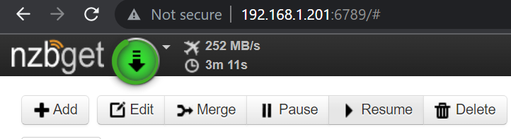

  7. Just hit 330 MB/s. The connection still says "unknown" for my WAN, but based on what I've read that is just the way it is with the Intel X550-T2 NBASE-T when it connects at 2.5Gb or 5Gb. I guess since I am hitting over 300MB/s the connection must be properly negotiating at 5Gb. EDIT: Evidently it's a known issue with the FreeBSD drivers for the Intel X550. The connection is reported 'unknown' when negotiated at 2.5GB or 5GB. I have since hit and maintained 350 MB/s at times when my ISP has the available bandwidth, so I am pretty certain the Intel X550 and modem are connected to each other at 5GB. This is cool! craigr
  8. Welp, tried a lot more and all you suggested for pfsense. No joy. Just now installed opnsense in about five minutes and BAM!!! It was bouncing up to 244 MB/s as well. No more time now, but wow, just wow. I wonder what is wrong with pfsense. craigr

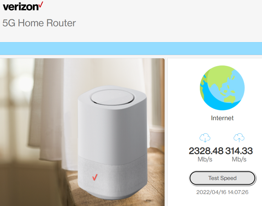

  16. I'm not sure, but perhaps newsdemon is just running slow. After my post las night, there have been times when the speed picked up, but not consistent like most times in the past. I may have to just wait and see over a couple days. With speedtest.net I am indeed able to maintain over 2000 Mbps down. I am on a VM attached to the same unRAID machine running pfSense. I gave pfSense three cores (six with HT) and they are all maintaining low utilization even when downloading at maximum speed. I've tried different amounts of RAM and have settled on 1GB for now as it never seems to go about 25% utilization. I am using virtio as as my network model. "If normal speedtest is OK, check other design "flaws", like running via L3/routing (did you run the test on a single network or maybe two?)." This I am not sure about what you mean. How could my nzbget docker be running L3 routing? And please explain further "on a single network or maybe two." Once again thank you! craigr
  17. So this is working well for me now with only one problem. My binhex-nzbget docker is only downloading around 60MB/s now, where I am getting ~235MB/s with my ISP router. I think I've been at it too long. I'll have to look tomorrow and see what I find. Thanks again, craigr
