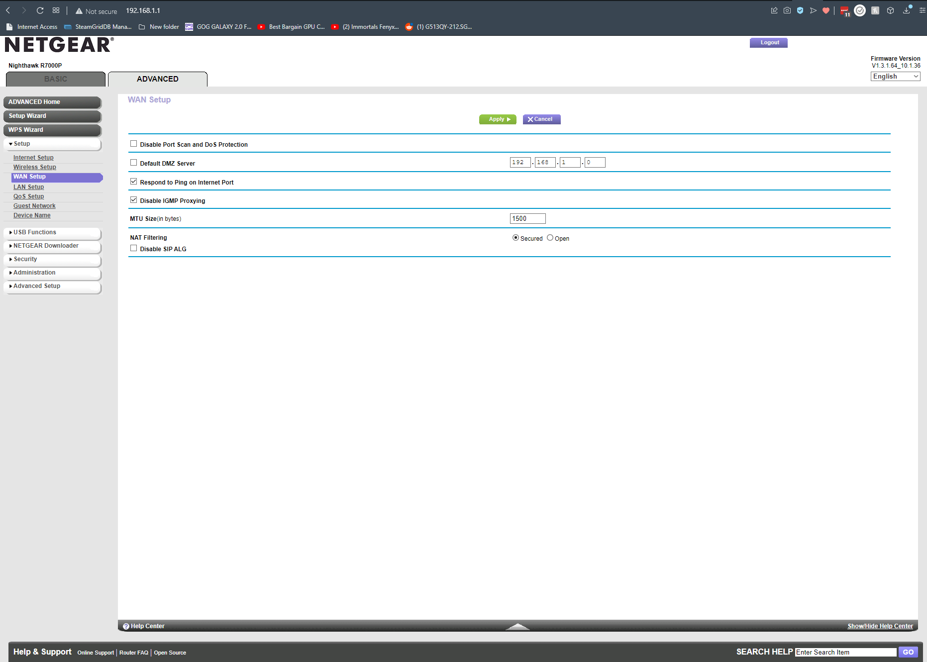

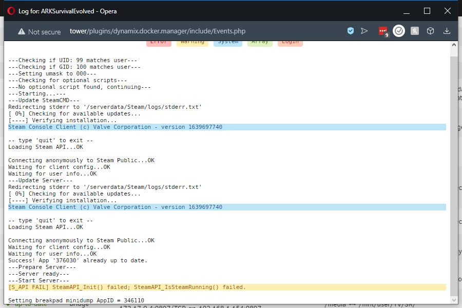

  1. I can see it at 192.168.1.154:7777 only - and i can connect. Not on external Ip:27015, internal ip:7777, internal ip:27015 or any other combination. fixed- thank your for letting me know it is not necessary. Back to bridged. In addition i shut down and rebooted the unraid server, with all other dockers and my one VM set to not autorun. This did not seem to help. I tried Privileged, that didn't solve it. Also i eliminated the RCon port as suggested by Mushroom.
  2. I am at a loss as to why my single (not cluster) Ark survival evolved server will not show on the internet. I will reiterate and add a few things from my previous post which starts here. To be clear i am asking about Ark, but reference Valheim as it has been working fine. Valheim container is working and has always worked from external connections. Yet Ark just won't be seen or connect via external connections, just on my local network. Every other game server i have used from this repository/thread works perfectly. I understand port forwarding on my router At this point, I have the following ports mapped on my router 7777,7778,27015 udp only, 27020 tcip. Testing with a cell phone tethered laptop, I am able to connect to valheim which uses udp ports via typing the IP address in But i do not see my valheim server in the steam server favorites. I tried 2 udp port scanners. one has an error writing to my port on all udp ports i tried to test, 2456 etc for valheim, and 27015 for the following udp port scanner. https://openport.net/udp-port-checker/ (this one doesn't work) But https://www.ipvoid.com/udp-port-scan/ does connect to all the udp ports as open/filtered. it lists the service for 7777 as cbt, 7778 as interwise, and 27015 as halflife. I was asked the following question from Ich777 Are you sure that your ISP is not blocking any ports or you are behind a NAT from your ISP? -I have called my isp to ask if they are blocking udp ports or specific udp ports. They said they don't block much, just a few russian military IP's that have been trying to hack them. Also I don't believe they are because if i can connect to valheim externally and the above port scanner shows all the ports as open/filtered. I believe this is unrelated but i discovered that my router nighthawk r7000p was using a 2 year old firmware and not reporting that updates were available. I updated to a recent firmware this morning to eliminate that issue and be more secure. I cannot see my server at https://arkbrowser.com/ I cannot seem to find it when i download all the servers with the boxes checked on my compute (this one is on the same network as unraid/ark server) I cannot see the game via tethered laptop and the ark server browser. Do you have other services exposed to the internet? - i have many computers on the network and i have a few other services exposed for sure, but none on 27015 to the best of my knowledge.. Or 7777,7778 (if that matters or should i forget about those ports for my connection issue?). Here is my run script for the server root@localhost:# /usr/local/emhttp/plugins/dynamix.docker.manager/scripts/docker run -d --name='ARKSurvivalEvolved' --net='bridge' -e TZ="America/Anchorage" -e HOST_OS="Unraid" -e 'GAME_ID'='376030' -e 'VALIDATE'='' -e 'MAP'='TheIsland' -e 'SERVER_NAME'='IcyWaves' -e 'SRV_PWD'='deleted' -e 'SRV_ADMIN_PWD'='deleted' -e 'GAME_PARAMS'='?MaxPlayers=11?' -e 'GAME_PARAMS_EXTRA'='-server -log' -e 'USERNAME'='' -e 'PASSWRD'='' -e 'UID'='99' -e 'GID'='100' -p '7777:7777/udp' -p '7778:7778/udp' -p '27015:27015/udp' -p '27020:27020/tcp' -v '/mnt/user/appdata/steamcmd':'/serverdata/steamcmd':'rw' -v '/mnt/cache/appdata/ark-se':'/serverdata/serverfiles':'rw' --restart=unless-stopped 'ich777/steamcmd:arkse' 8dce2f7d187d21eebe6bc311f5275bdb2deec3f050ca6d474f0b58e475b10451 I also changed the following setting in my router "Respond to Ping on Internet Port" to enable it. I tried Bridged and Host network, but not sure how to try the specific IP:br0 option. Nothing seems to work. Attaching the screenshot of router that might be affecting? and the log from the docker Any more suggestions? or data that i might provide to help see what's going on?

  5. I have been working on reading through the forums for quite a bit here and can't seem to find the answer. Can someone point me in the right direction for a single Ark server. I see the stickied Cluster info. I can see my server and connect to it locally no problem but my friend cannot connect externally. 1. What are the specific ports to be forwarded and connection type? 2. How should a friend be trying to connect to my game from steam? 3. Can i test my own connect-ability by adding my external IP address and a port to my server list on steam (clicking view, then servers, then adding it by my external ip and port? 7777? 27015? The ports i have forwarded at this time after reading the forums are 7777,7778,27015 UDP only, and 27020 TCIP. But i did leave in 27016 UDP only. Why is IppoKun talking about 26900? in the post above, did i completely miss that port? Thanks in advance and sorry if this is clearly spelled out in this thread already?

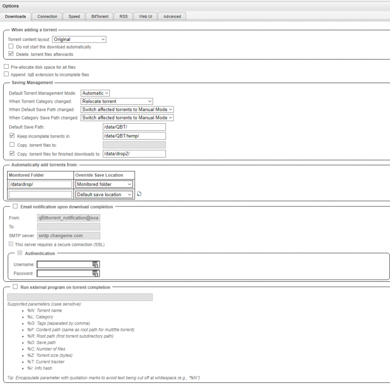

  6. I think I am good to go now. I moved all the files out of the appdata folderafter it finished doing whatever it was doing. I had to create a new folder for my torrents and then edit categories. So many things are not obvious with this program, but once its working it works pretty well.. with the exception of todays little nightmares. Thanks again for your help wgstarks!

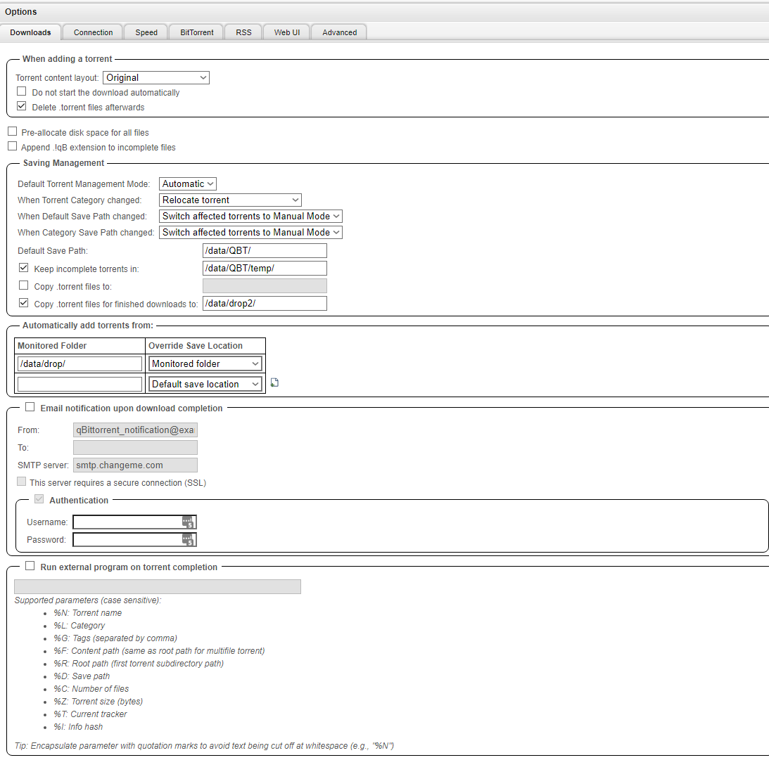

  7. It would appear that when the update to the broken qbittorrent the unraid server moved files from the array to the cache drive and put them in this directory "/mnt/user/appdata/binhex-qbittorrentvpn". This one does not get moved off the cache. I tried to download another torrent prior to reverting the version of qbittorrent as suggested and it also went into the same folder. Normally it should go into /data/QBT/temp/ and then move to /data/QBT/ once it is completed. Now whenever i am running qbittorrent the cache drive reads and writes are maxed out at the same time, even though i have deleted all the existing torrents and just did one test download of 10GB which is stuck at moving. Is it possible that Qbittorrent is still moving all those files around on my cache drive? Because when i shut down the docker the writing/reading stops and then i can manually start the mover script on docker/main and it moves over a bunch of the previously torrented files according to the system log with logging of moved files enabled. I think it may be fixing itself? Edit. Also thanks for posting your working settings, i will try them after i let this play out, the Downloads folder in the appdata folder is getting smaller each time i run the qbittorrent... What or why i don't know.
  8. Do these settings look ok? Perhaps this has something wrong as well. - i did a test download and its stuck on "moving" -
  9. I deleted a few of the variables for privacy, but here it is. root@localhost:# /usr/local/emhttp/plugins/dynamix.docker.manager/scripts/docker create --name='binhex-qbittorrentvpn' --net='bridge' --privileged=true -e TZ="DELETED " -e HOST_OS="Unraid" -e 'VPN_ENABLED'='yes' -e 'VPN_USER'='DELETED' -e 'VPN_PASS'='DELETED' -e 'VPN_PROV'='pia' -e 'VPN_CLIENT'='openvpn' -e 'VPN_OPTIONS'='' -e 'STRICT_PORT_FORWARD'='yes' -e 'ENABLE_PRIVOXY'='yes' -e 'WEBUI_PORT'='8080' -e 'LAN_NETWORK'='192.168.1.0/24' -e 'NAME_SERVERS'='209.222.18.222,84.200.69.80,37.235.1.174,1.1.1.1,209.222.18.218,37.235.1.177,84.200.70.40,1.0.0.1' -e 'ADDITIONAL_PORTS'='' -e 'DEBUG'='false' -e 'UMASK'='000' -e 'PUID'='99' -e 'PGID'='100' -p '6881:6881/tcp' -p '6881:6881/udp' -p '8080:8080/tcp' -p '8118:8118/tcp' -v '/mnt/user/Torrents/':'/data':'rw' -v '/mnt/user/appdata/binhex-qbittorrentvpn':'/config':'rw' --sysctl="net.ipv4.conf.all.src_valid_mark=1" 'binhex/arch-qbittorrentvpn:4.3.3-1-07' 004c3ff1289adab9e8d635471e591f4fd3a9ef8f2e08215162153710ca954d82
  10. Thanks! - i rebooted the server, still every time it was moving files and filling up my cache drive, so i just deleted all of the listed torrents, which may have solved it. Now i just need to move all the extra stuff out of my appdata folder that seems to have been dumped in there by qbittorrent. At this point i don't know if i still have a problem with my cache drive integrity as the error hasn't been back since rebooted. Not a good day but hopefully my data and server are intact. Brain overloading a little.
