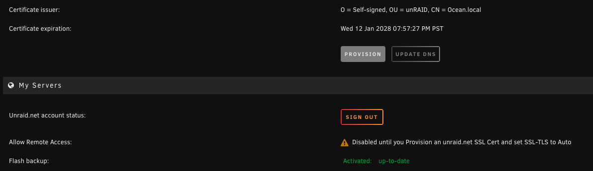

Hmmmm SSL?
I hit Provision and got a good message back, but still I see this. What do I need to do to fix this? (Why is it "Disabled until you Provision an unraid.net SSL Cert and set SSL-TLS to Auto" for which both have been done?

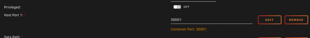

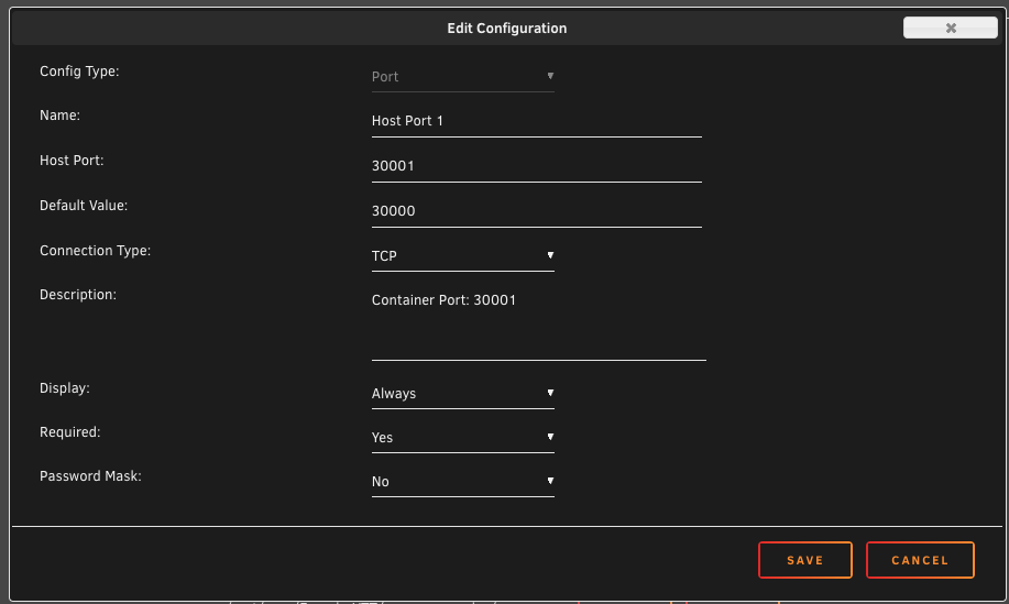

[Support] fithwum - FoundryVTT
I can't seem to get this to run on any port other than 30000. I'm using "host" network and tried to remove and re-add the port as host port 30001/default 30001. (suggested above) (Incidentally, I don't see "container port" even showing up in the port config.) Is there a config file I can edit by hand? Anything else I can do?
