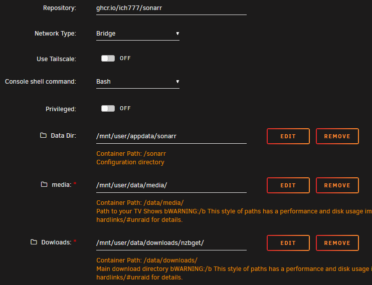

  19. I've been trying to reset my data folders according to the instructions in your containers: Path to your TV Shows bWARNING:/b This style of paths has a performance and disk usage impact: bslow, I/O intensive moves/b and bwasted disk space/b. See https://trash-guides.info/hardlinks/#unraid for details. For example, I've set up Sonarr as follows: Share settings: However, moves after download still seem to be doing a bit-by-bit move, as I can see the filesizes slowly ticking up. I think I've done everything in the guide, any ideas what I'm missing? Run command: docker run -d --name='Sonarr' --net='bridge' --pids-limit 2048 -e TZ="Europe/London" -e HOST_OS="Unraid" -e HOST_HOSTNAME="unRAIDpvr" -e HOST_CONTAINERNAME="Sonarr" -e 'SONARR_REL'='latest' -e 'CONNECTED_CONTAINERS'='' -e 'UID'='99' -e 'GID'='100' -e 'UMASK'='0000' -e 'MONO_START_PARAMS'='--debug' -e 'DATA_PERM'='777' -l net.unraid.docker.managed=dockerman -l net.unraid.docker.webui='http://[IP]:[PORT:8989]/' -l net.unraid.docker.icon='https://raw.githubusercontent.com/ich777/docker-templates/master/ich777/images/sonarr.png' -p '8989:8989/tcp' -v '/mnt/user/appdata/sonarr':'/sonarr':'rw' -v '/mnt/user/data/media/':'/data/media/':'rw' -v '/mnt/user/data/downloads/nzbget/':'/data/downloads/':'rw' --restart=unless-stopped 'ghcr.io/ich777/sonarr' 1bbbb4fe0e64b514ff97a57ff4ade9c44c6116075089bbd3740c55df817b7412
